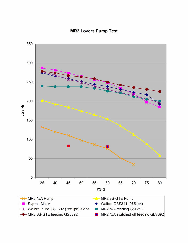

just google mr2 fuel pump test to see proven #s, to how the stock pump (even the turbo pump) gets weaker as you turn up the boost, because of the elevated pressure.
every psi of boost adds 1 psi to your fuel pressure. so @ 15psi, the pump thats been running for 20 years @ 36psi or whatever stock pressure is, is now @ 51psi, and struggling to keep up with flow demands.

heres the flow chart of the diffrent pumps...look at how the na pump really looses flow as pressure goes up.
