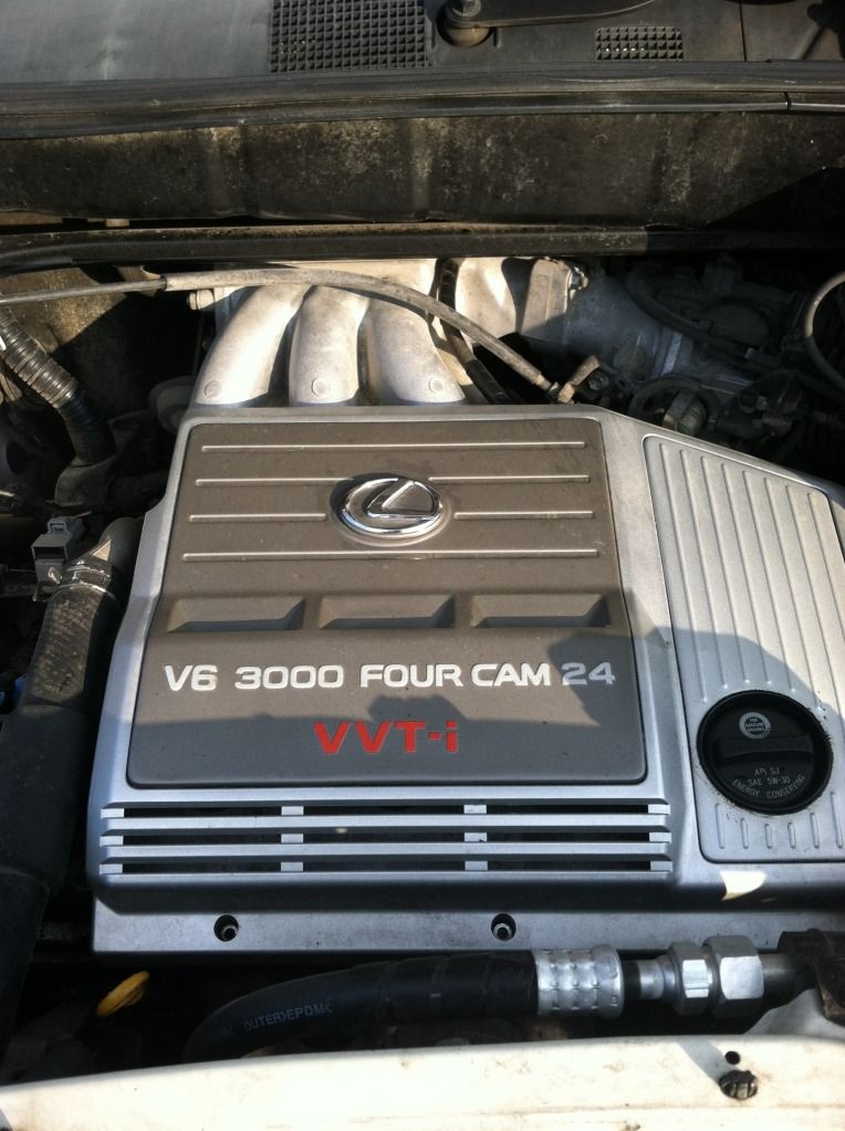

richee3
Proof of the VVT-i 1MZ, sitting in the engine bay of my RX 300.
And a picture of the sweet dual throttle body setup, as well as confirmation of drive by cable.
Despite my RX 300 being slower than watching grass grow, I can see how this would be a very fun engine in the Celica. I'd like to see more information surrounding the V6 swaps.
