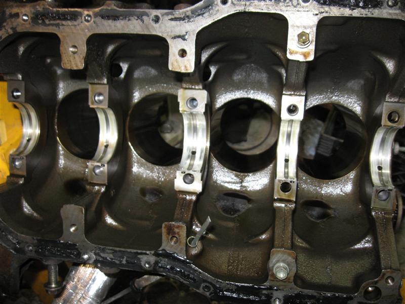

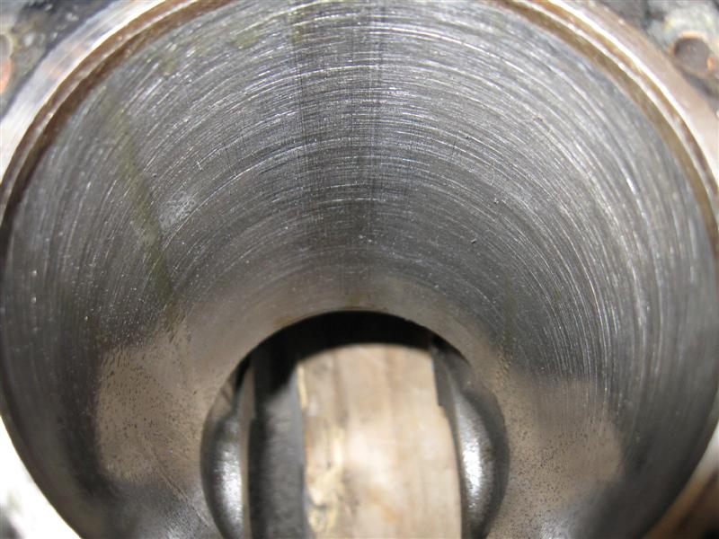

the block went out to get hot tanked last night, much easier than trying to clean everything out myself.
ill have it back today.
the block empty
after honing
i should have all the parts i need to put it back together by the weekend.
