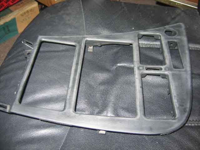

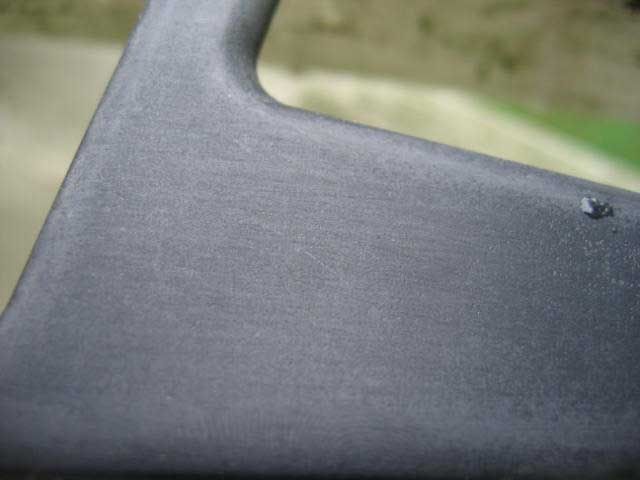

Manny, do you do any sanding before painting? Also what kind of primer do you use? and clear?
post Jul 13, 2006 - 8:52 AM
dustin15brown Posted Today, 09:19 AM
heres a pic of a radio trim surround im just starting to prep for paint.
this is my first sanding step with 220 grit wet/dry paper (used dry)
ill continue up from there to 1500, and start wet sanding @ ~800 grit or whatever
heres a close up of step 1 (220 grit) gives you an idea of how much sanding is involved to get it smooth, this is prolly 1/2 or more...still prolly another 15-20min before i move up.
ill add more pics this weekend, i need to go get more sandpaper.
once im all done with the prep,
its all testors 3oz. cans..grey primer, color, and high gloss clear
i LIGHTLY wet sand the last couple coats of color, with 2000 grit paper, then throw on 2 or so coats of clear, then again lightly wet sand that in between 2 more coats, with the 2000 paper.
its important to make sure all the paint is FULLY dry before you do any kinda wet sanding.
