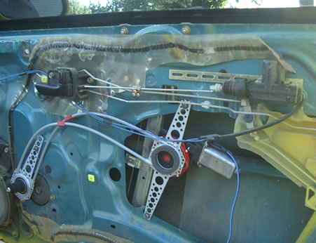

And for the power door lock actuators, I installed these myself as well. Mine were the two-wire ones, and I didn't have to run a 12 volt line into each actuator. Do you have the five-wire ones?
Also, here is how mine are mounted:

Lol, those braces look cooooooool

Coomer you are helpful. Way more helpful than that microsoft word paper clip. Two more things...
My actuators look exactly the same as yours, they came with some little black boxes and why I do not remember the name I do not know. Those need 12v constant?
