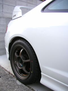

Dec 3, 2004 - 6:17 PM
QUOTE(jgreening @ Dec 3, 2004 - 2:13 PM) There is a picture somewhere that Coomer posted with a white car with 8" rims and a 35 offset that had an almost perfect flush look. Keeping in mind that 1" = 25.4 millimeters (one half of which is 13mm), the correct offset could be as low as 23 (at least for the rears). See this link: offset calculator [right][snapback]216439[/snapback][/right] ![]() 17x8" rims with an offset of 35. -------------------- New Toyota project coming soon...
Dec 3, 2004 - 6:40 PM
damn....thata 100% the look im going for!!!

Enthusiast ![]() ![]() ![]() ![]() ![]() Joined Aug 29, '02 From ny to philly Currently Offline Reputation: 0 (0%) |
QUOTE(Coomer @ Dec 3, 2004 - 7:17 PM) ![]() 17x8" rims with an offset of 35. [right][snapback]216471[/snapback][/right] what kind of wheels are those? they look like black racing pro n1's but they don't come in that size http://www.1010tires.com/wheel.asp?wheelbr...ro+N1+%2D+Black |
Dec 3, 2004 - 7:02 PM
Maybe 1010Tires doesn't carry all of the sizes available(because I know there is a 18x9" version as well.)
