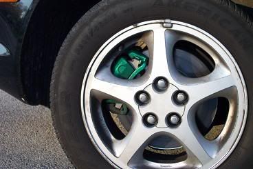

sorry if it's huge. duplicolor green though, it had a shiny lid. dont recall what it is. They're about 1 1/2 years old, REALLY need cleaned though. Shiny!
