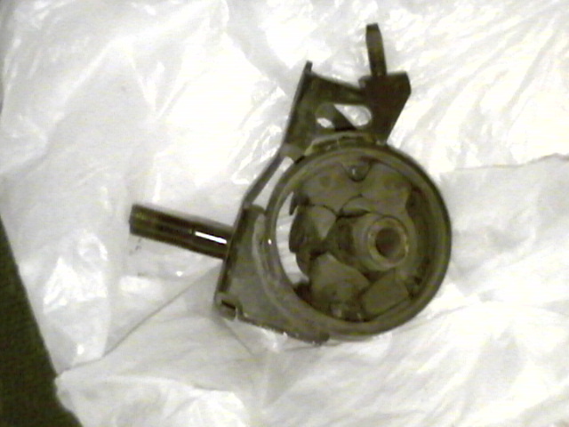

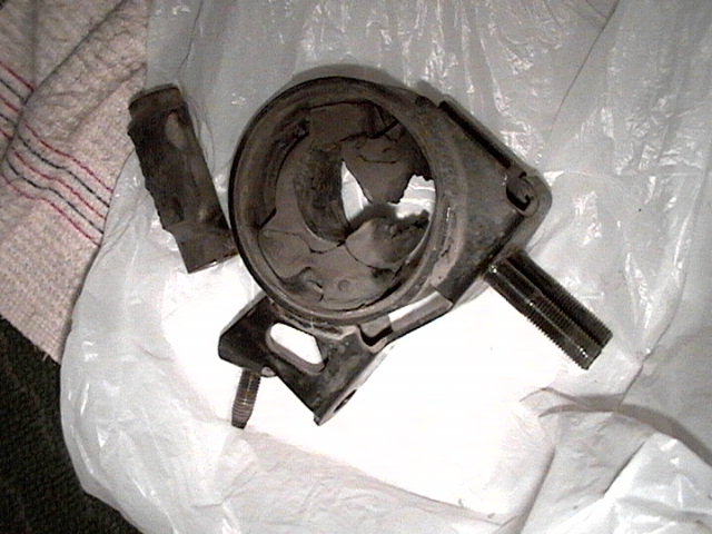

i bet your rear motor mount is shot too. its common to wear them out quickly if you do a lot of hard driving. you can fill them with polyurethane and that should help the wheel hop. i just filled mine, check out this thread: http://celicatech.com/forums/showthread.php?t=10385

lagos,
did the polyurethane you ended up using cause any unwanted vibrations?
