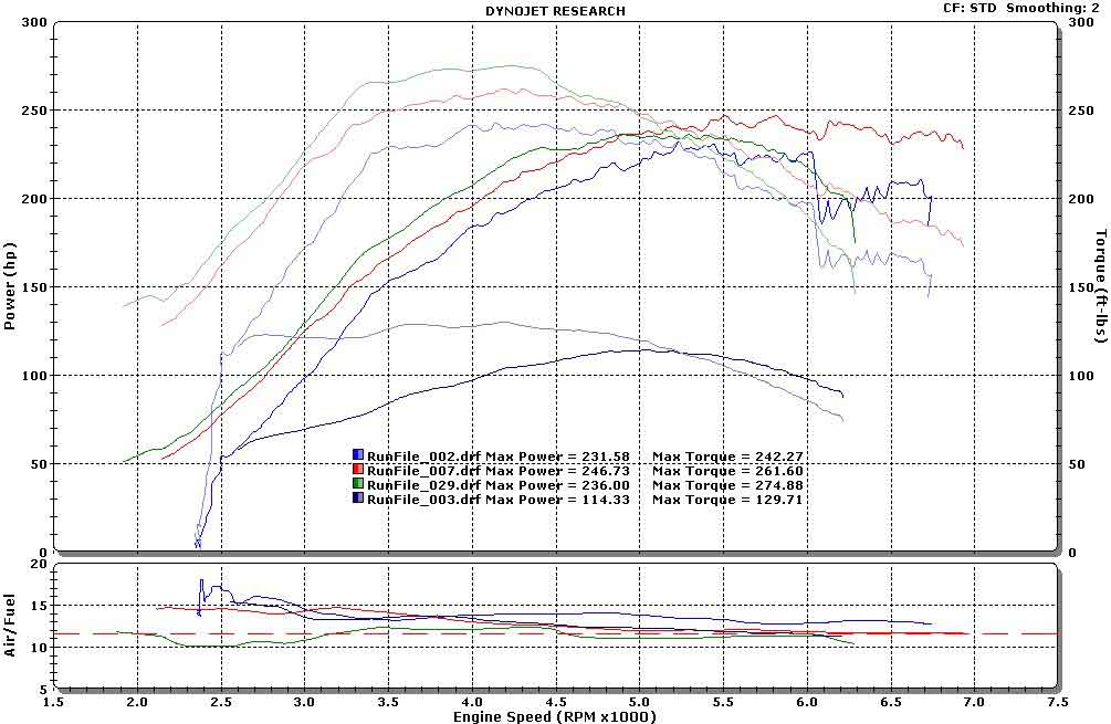

Hey guys,
I went to the dyno this weekend to find out what numbers I'm putting down. I came out very impressed. I was thinking along the lines of 230 hp to the wheels.
New Dyno Video 10MB
At 17.5 PSI, I put down 246HP and 261 TQ. Just insane.
Look at one of my run files below. I am still having trouble tuning my boost controller. You'll notice that after 4,000 rpm I have very strange spikes in boost. The theroy we have is, the controller is opening and then closing my waste gate door over and over after 4K. In the next few weeks I'll be tweeking the profec to run a constant number, then go back to the dyno. I believe I can squeeze out a couple more horses once this thing is set properly.
If you have any suggestions, I'm more than happy to hear them.

Nice air fuel curve! congrats man

nice numbers and VERY nice air/fuel curve. i wonder how much your new fuel rail has to do with that?
ps. you need an mbc..lol

I really wish now that I did a before and after with the rail. The MBC sounds tempting wink.gif

change your plugs and check them after letting the car idle for a few minutes. if they are not crazy black (like they normally are) ,then i would be willing to bet that the rail has something to do with the a/f curve.

The rail helps, but most of the A/F curve is due to the RC ECU.
As I Think about it. I can dig around for the plugs that came with the clip.
When I change my plugs, I'm leaving them in for a long time. Pulling plugs is at least and hour long process for me.

the rail has nothing to do with the curve.
all the rail does is lower the pressure drop across the rail.
if anything, it'd make it richer.

Agreed.
Very nice numbers. You are still on the ct26 right? If so, thats damn impressive.

wow damn thats awesome jeff...those numbers and that a/f curve looks good as heck smile.gif
