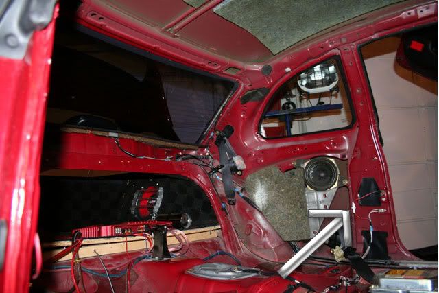

If you take off the back speaker cover you should see some wires for your door. You can unhook that and then it won't know if the door is open or closed. You can also put I switch there if you really wanted to. The only thing with disconnecting the wires is that your alarm wont work or at least that how it was with mine.
where the crappy arrow is. I don't know but thats what I did.
-Brad

QUOTE(C3L1CA @ Jun 27, 2006 - 9:24 AM) [snapback]449515[/snapback]
THats what i did it works great
