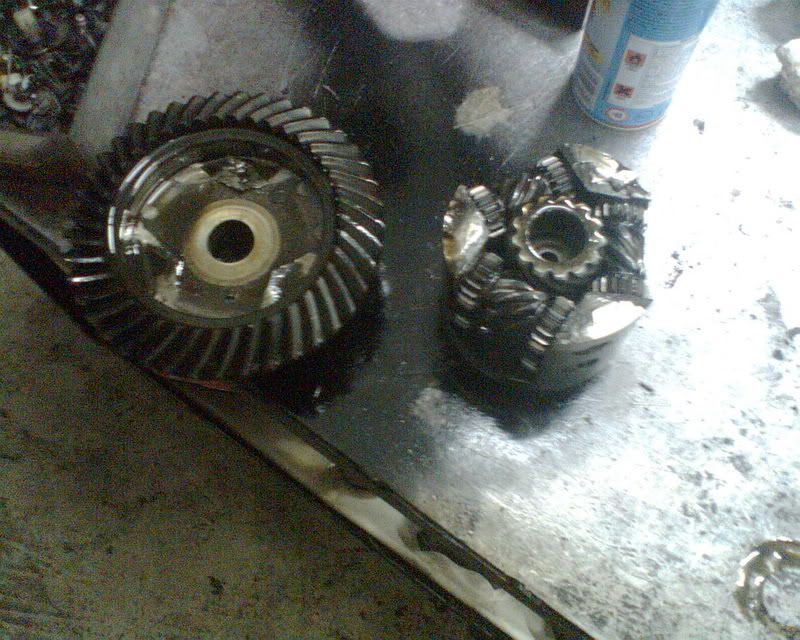

here is how my diffrential broke.
gears are in perfect conditon.

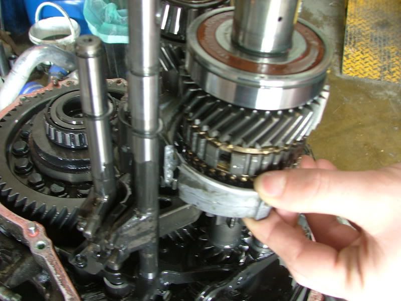

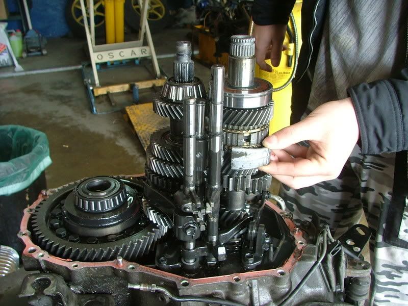

i had one more proplem last week. i broke 3rd gear selector. its not only upgrading gears and shaft, i need stronger fork selectors for sure.
