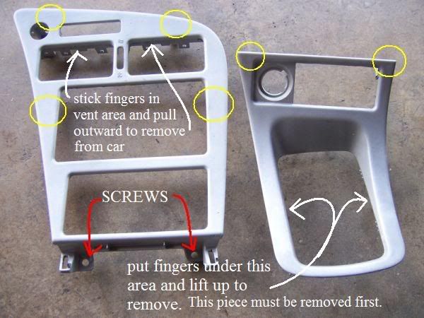

Here is a basic explaination of removing the center pieces.
The yellow circles represent where clips are supposed to be (mine is modified so I don't have all the clips it should have, but I labeled the picture as if the clips were still there). There are also clips on the sides of the shifter surround but it's pretty simple to remove. All you need to do is pull up on the shifter surround, and then just unplug the cigarette lighter when you have it up. The convertibles have switches there that need to be removed. After you remove the shifter surround, you will see two screws on the bottom of the other piece. Just remove those two, and you will be able to pull that piece out. Basically point your vents all the way up, stick your fingers in there, and pull outwards. From there, you should know what to do. You will need to unplug your clock and your hazard lights switch.

Here is a better look behind the shifter surround to give you a better idea of where you will need to apply lifting force in order to remove the piece. Again, yellow circles represent where clips are present.

thanks for the removal piece!
got it in one hit!
