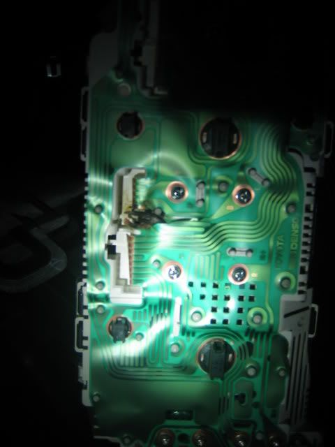

this is apic of my fried inst. cluster. this is what caused malfunction of speedo and high beam indicator lamp. Thanx to defqeph's video. More pix comin'!
This post has been edited by heinzi98: Dec 16, 2007 - 10:48 AM
post Dec 16, 2007 - 8:10 PM
QUOTE(heinzi98 @ Dec 16, 2007 - 10:43 AM) [snapback]623177[/snapback]
holy smolly, how did it fry? did water get there? did you find another speedo. I think you can replace just the plastic with the copper so you dont have to remember the original miles..

This is the way I bought it. I'm not sure what happened. I think previous owner smacked the front end, bent a wheel, broke motor mounts, and more. I believe the nose was replaced (used) radiator replaced (new) something probably got into the heater core to crack it and somehow a short blew the instrument cluster. Thats when they said "f*** it" and sold it. I bought it on ebay for $3150.00. I still love it and promise to put this car together nicely.
