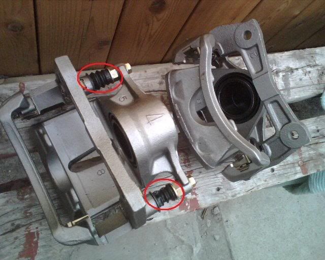

so the thing the caliper mounting bolt screws into is supposed to slide in and out, correct?
Because one of them slides but the other one is stuck so i can't slide the caliper over the new brake pads because this piece won't slide in
Help Please

wow i'm confused.
the caliper is fine, the piston compressed with no problems.
the things the caliper bolts into should move in and out freely so the caliper can fit over the new brake pads. but one is stuck. i am talking about on the bracket, not on the caliper.

QUOTE (Promasta @ Aug 7, 2008 - 7:35 AM) *
wow i'm confused.
Now I'm confused. The bolt you're referring to in your picture is the caliper bolt and has nothing to do with holding it onto the backing plate. Granted, it should unscrew, and if it doesn't, it may be that your caliper is seized. However, unless your caliper is seized in a closed position, you don't need to unbolt the bolt you're referring to in the picture. There are two 14mm bolts that hold the caliper in place to the backing plate - one is to the right of where the caliper is, almost directly in line with the axle. The other is at the bottom of the bracket, just below the caliper itself and toward the center of the wheel a bit. You should be able to remove the caliper just fine without removing the caliper bolt, at which point it'll not only be easier to see if the caliper is seized, but if you remove the caliper all together, it'll be a LOT easier to remove that caliper bolt if necessary.
PB blaster is your friend, too. You might soak that caliper bolt in PB Blaster for a few minutes if you can't get the bolt out. I rebuilt my entire caliper basically using PB Blaster, a ball-peen hammer, and a pointy metal thing. Lots of corrosion inside that chamber where the bolt goes through. Works great now.

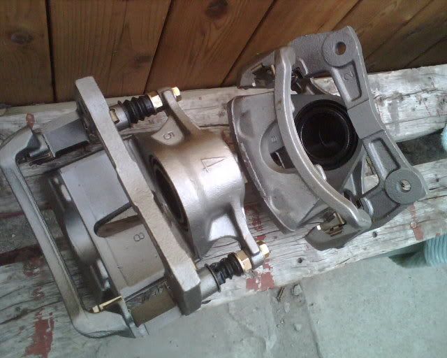

there are two little pistons/pins on the caliper bracket that go in and out. see below
i think what he's saying is the main caliper piston on the caliper is ok. it's these little pistons/pins that slide in and out is what seized up. as the pads get thinner, these slide inwards towards the rotor. when you get new pads, they have to slide out but if one or both seized, then you're stuck with using the old pads until you get it fixed or until you get new brackets.

yes azian that is exactly what i am saying
sorry i didn't have a good picture and didn't know how to explain it
