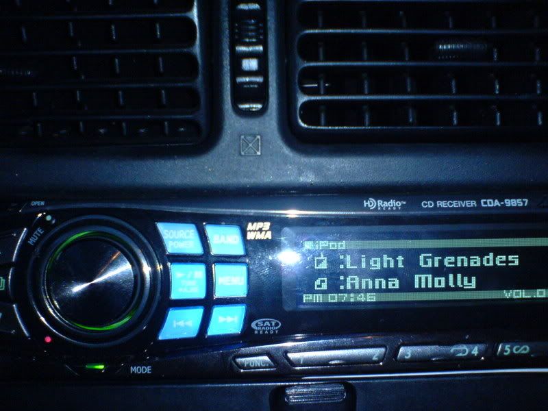

So when I got my car, there already was an aftermarket Pioneer head unit installed with a lidded pocket underneath it. With the Pioneer installed, it didn't have a problem with letting the face fold down to let me insert or eject a CD, but with my new Alpine CDA-9857, the trim panel around the radio kinda sits on the faceplate and won't allow it to open. It did the same with the CDA-9855 I have but would still allow the motorized face to open every once in a while. I'm not too concerned about the CD part since I have an iPod cable now, but it just bugs me that it does this, so I might have to shave the panel around the radio down a bit. Did anyone else have this problem? Is it just a matter of design for the radios? What installation kits do you guys have?

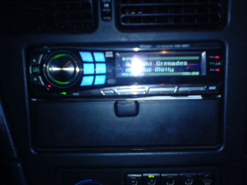

Those are pics from last night, but it pretty much gives a general idea of what it looks like.

I had this same problem, strange thing was when i first put in my radio it worked fine but then i was working on it one day and it did this when i put it back together. I solved it by putting the pocket on top then it hit the trim to, so i took a file and shaved the corner down alittle biggrin.gif works good now and its not noticeable at all since it didnt take much.

I just filed the top of portion of the shroud that touched my head unit. Its a nice tight fit and it doesnt rub of get stuck.

Alex - all you have to do is take the bracket's monting holes with a small round file and elongate them upwards slightly until the radio clears. Still attached to the radio is fine as long as you mind the chips. You can see how much I did mine to get an idea. Now my face sits flush with the bezil but doesn't rub on the top.
