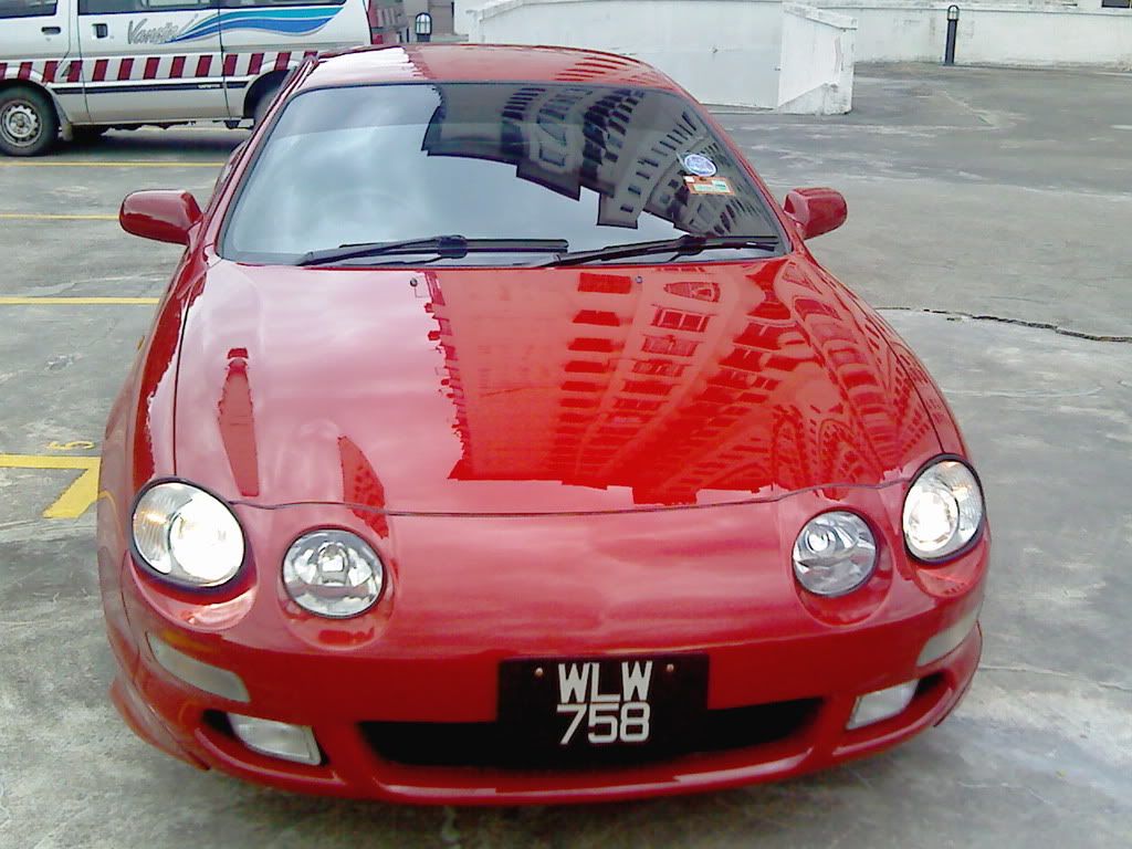

Thx Rayme for the lenses...

looks good!

your license plate there kicks ass. like it.

Well intact i like the US based plate. Correct me if im wrong, since u car write whatever u want, i.e. ur name
