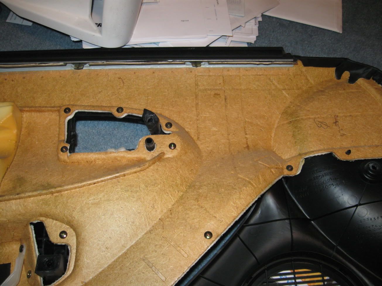

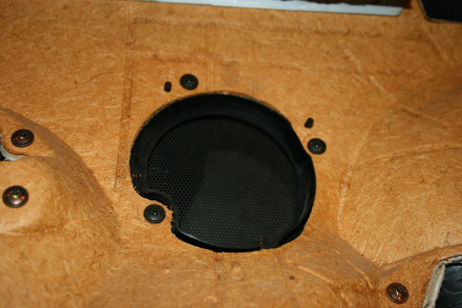

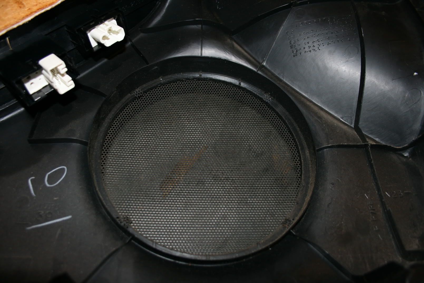

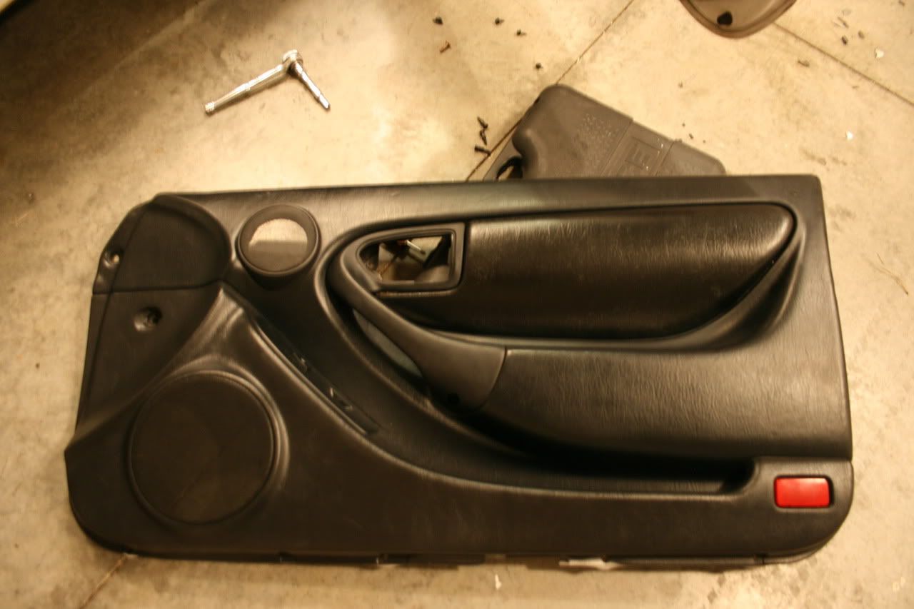

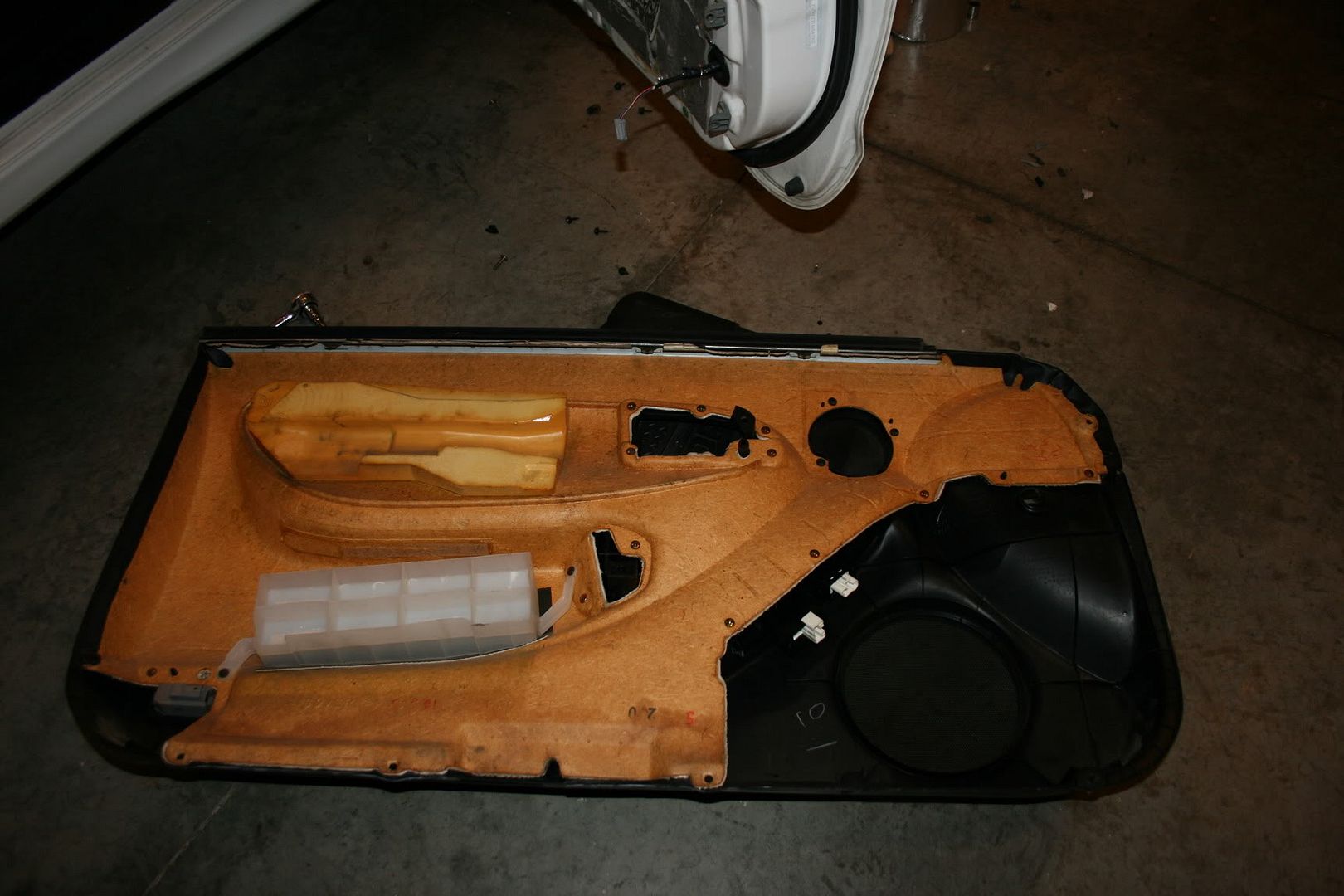

Front-
Back-
The 8" speaker grille-
The 4" speaker grille-
This is the back of the REGULAR door panel (just for comparison)-
