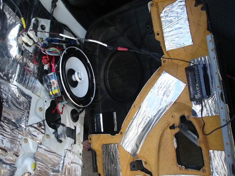

first hooking up the wires....
then it goes into the hole

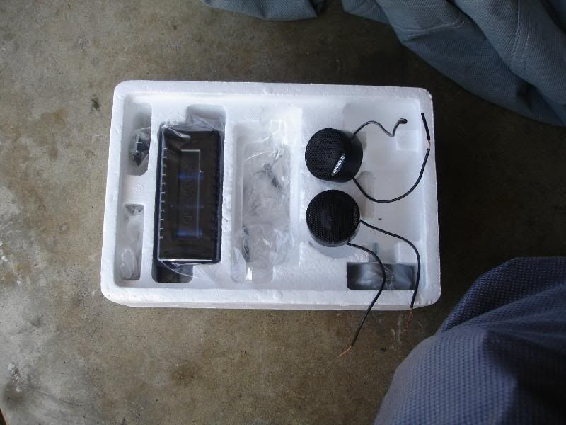

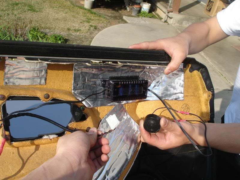

this where i mount my cross over amp for the tweeters...anyone else do it differently? i used velcro
Kenwood Exceleron tweeters

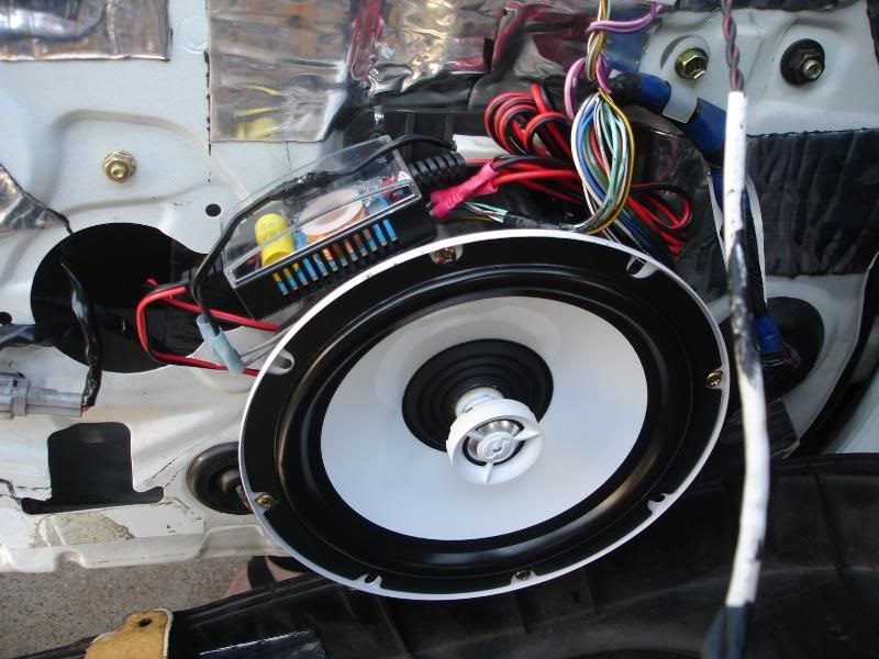

almost done...test fitting, another cross over amp came with the speakers...built in tweeter on speakers...
the speaker fitted...
