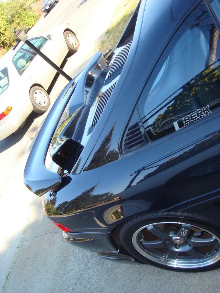

got the big intercooler setup in the trunk.
