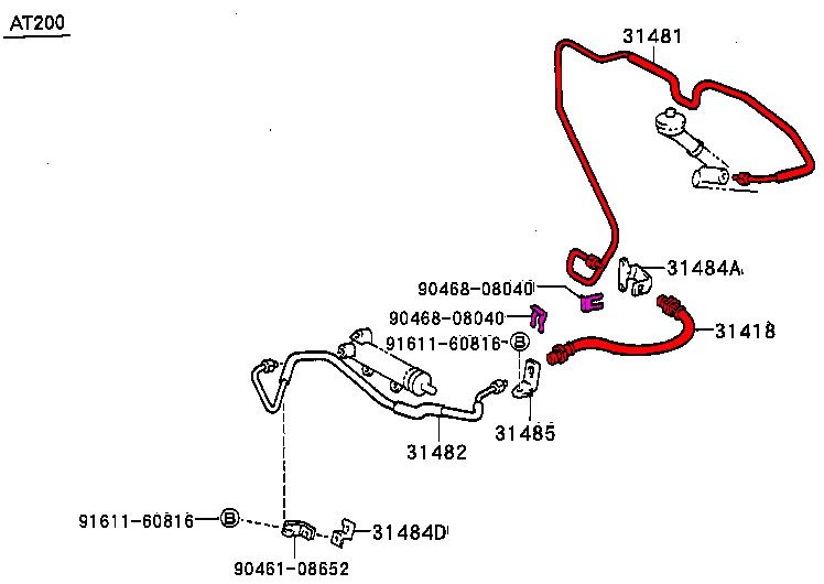

Okay suggestions ... wich one the hard line part order from gt4 or just the regular celica gt manual???? and also why not just a rubber line made for the brake system and get the fittings for that tranny ...

clutch hard line #31481-20750
the rubber line #90931-01108 (st204)

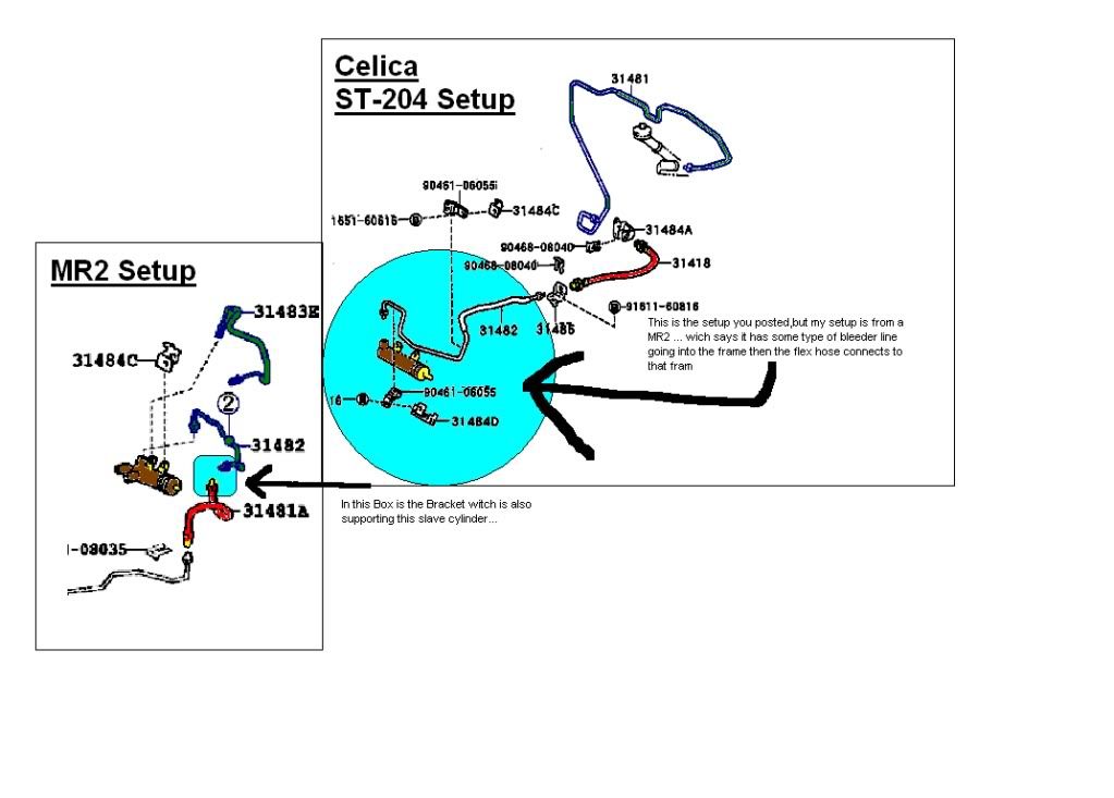

ok but heres the thing i have a mr2 tranny the e153 but off the mr2.. it has the bleeder line, then going to the frame holding the clutch.. then out of the frame is the rubber line going to the second hard line ... how do u get from the rubber hose you told me to buy then to go to the diffrent kind of slave cylinder .....

when I did mine I used my ST205 slave and lines, exactly because I was having issues finding the right hose for the stupid mr2 connection.
you can go to autozone and order a camry V6 manual trans slave and the line from the dealer, or maybe someone has a used one from the ST205 clip / engine set.
