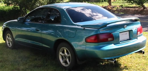

post Jan 26, 2003 - 5:46 PM
Here's my old dual exhaust setup on my car.
