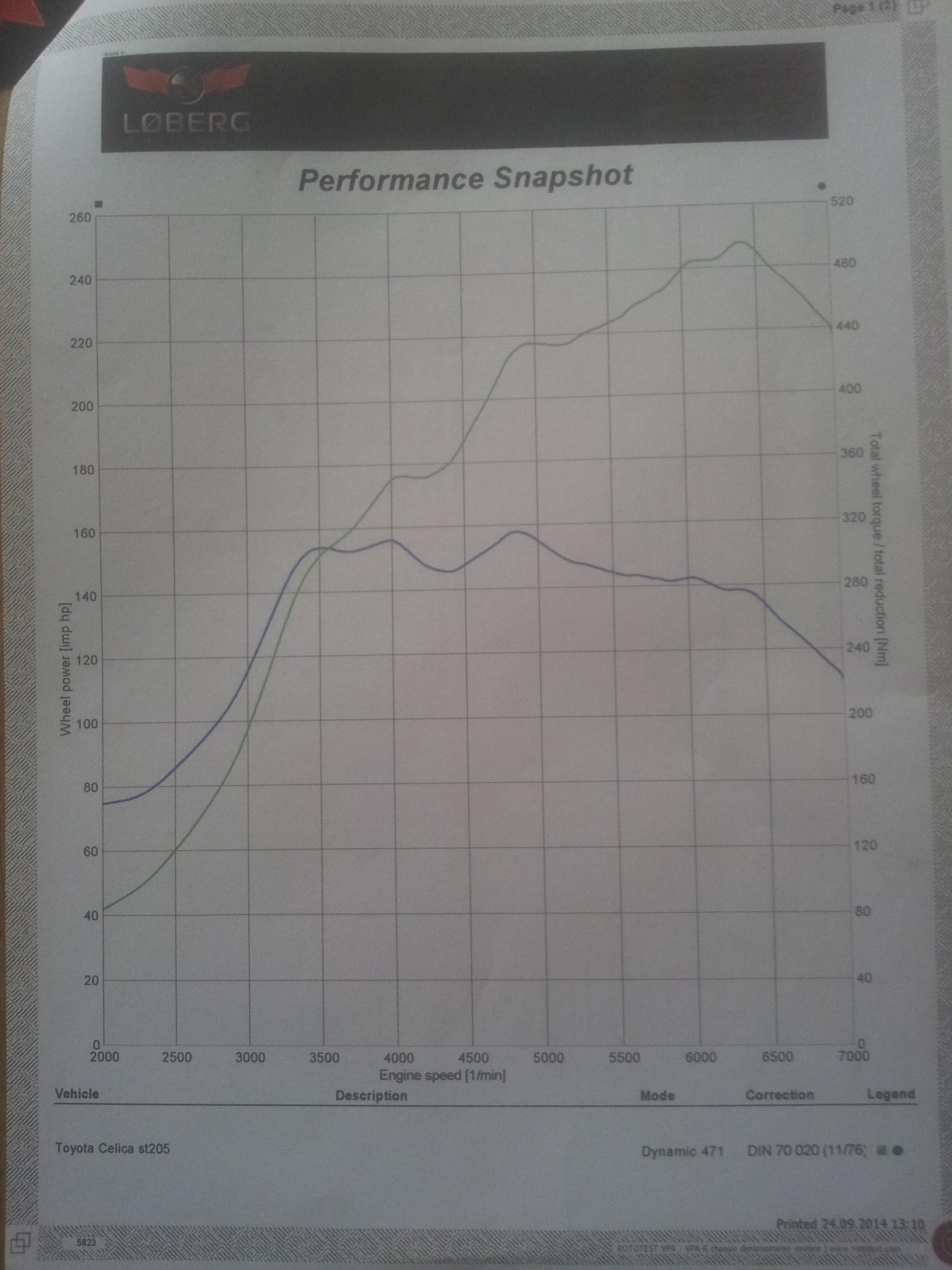

Here is the result from the dyno. Got the same whp now as stock bhp, happy with that. It feels so much stronger, the boost comes on MUCH harder. The map is set up to be safe, with 1.1bar of boost and the igntion dropping fast over 1.2bar. Boosting more than 1.15-1.2 didnt make much more power, as it only induced a lot of heat to the turbo.
