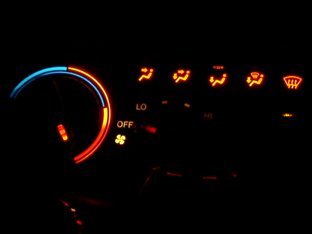

I've made it even easier for everyone to do. Ready ?
Take ur control box apart, pop off the buttons. Paint the inside of the box, and inside of the buttons.
Paint to use:
RED : Same paint for redding your tails Candy apple red
BLUE: Candy blue
Spray 2 coats ... let it dry and put it back together
your done
Enjoy ............. No more soldering !
Defgeph and I are working on a how-to article for this with more detail and more photos too. smile.gif

so are the leds inside still green? or u taken the green caps off?

why cant you eather.. replace to red bulbes, or chnage the caps, humm.. I going to have to look into this.. Nice work
post Apr 22, 2004 - 9:14 AM
They are LEDs, you cant just replace them like other bulbs, they are soldered in. So it was difficult to get into there and start to solder.
I think this is a much easier way.
I'm curious too, where did you find that red color?

give us a day or two ... The answers and pics are coming
sprynt - go to a hobby store and buy paint called candy apple red if you want red. if you want blue get candy blue.
*oh and yes take the green caps off the bulbs.
The how to is coming guys i have to take pics of everything
