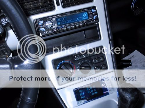

doggy did it thats where i got my idea to do it, hes the man.
heres mine though.

itchy's logged into his CD player as root! cooool! he's the ultra unix nerd

nice work itchy, looks very professional. So now I gotta ask, How do I do it?

trace the size of the afc on the plastic interior peice, cut out the hole with like a dremal. place the afc snuggly inside. glue it from the back. then used this stuff like bondo and smear it all over the edges. let dry. sand. sand. sand. then sand. then paint
