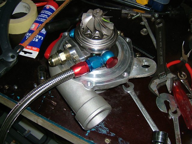

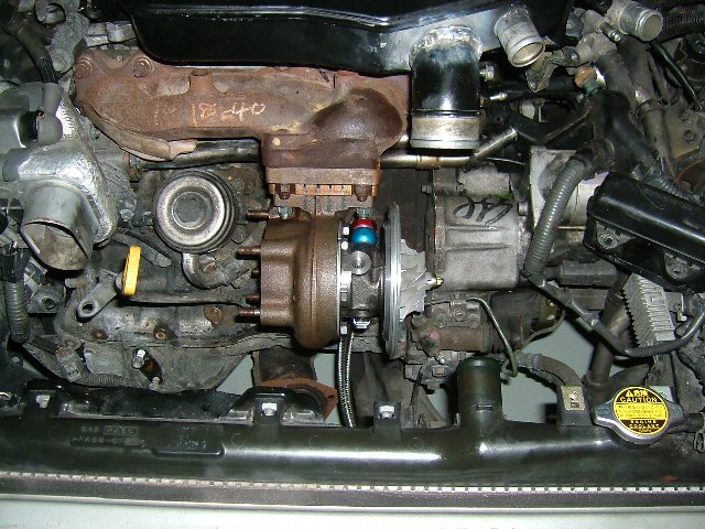

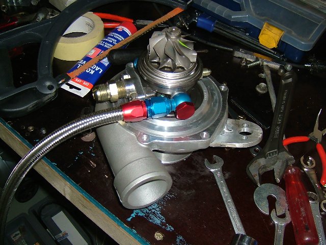

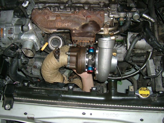

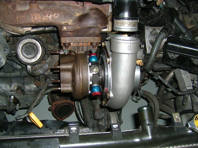

Ofcourse we started with getting rid of the old turbo (that was the start of all this, cos i blew off the wastegate of my stock turbo, that used to run on 1.25bar, which was just a little too much i guess). After removing the old turbo and trying to fit the new turbo, it turned out my aussie downpipe could not be used anymore, so we had make a new one, custom. We also had to replace the intercooler connection piece to the turbo. After all this was done, we could put on the turbo.

We put heatwrap on the downpipe so the exhaust gasses stay as hot as possible for faster flow. Then we put on the downpipe:

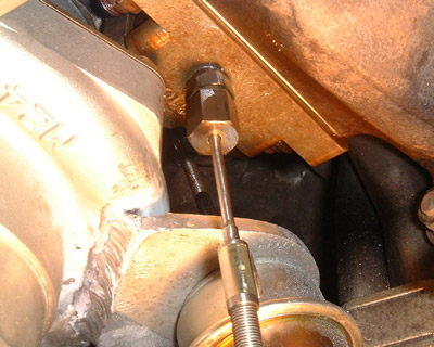

And to measure exhaust temperature, we made a hole in the adapter plate between the exhaust manifold and the turbo, so the exhaust temp is measured at the very best spot, right out of the engine, but not cooled down yet by the turbo or actual exhaust. This will of course be connected to the Apex'i gauge inside the car later on.

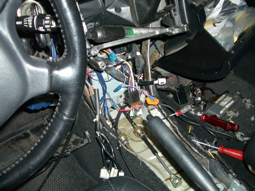

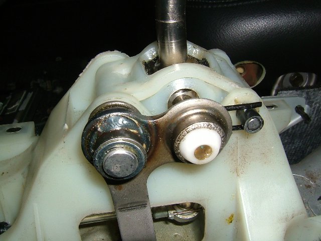

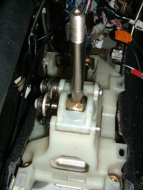

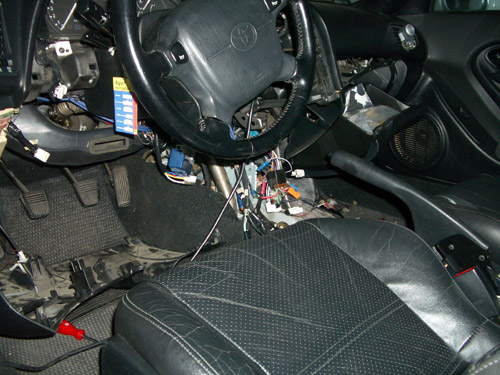

In the meantime we were also working on the inside of my car, we put in the turbo timer and the shortshifter:

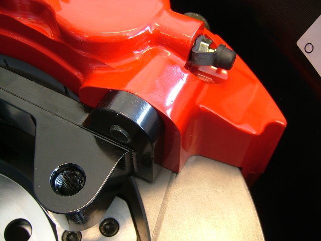

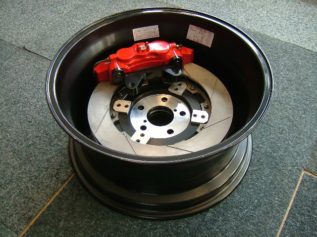

While we were working my car, Saunta Class came along and dropped off the rims and brakes. Here are some pictures of the rims, and some pictures with the rims with the customized 6 piston rotora breaking kit.

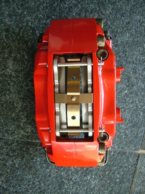

Here are some pictures of a 4 piston version:

Actually, this is really cool that you mention it, because Rotora does not make brake kits that are made to fit the ST205, but my tuner (Arnout, better known in the supra world) made it fit for me and can now deliver a kit if you want.
In other words, if you are looking for a really phat brake-upgrade, you can get the 6 piston Rotora braking kit through me and Arnout. Just let me know if you are interested.

Oh yeah, what kind of short shifter is that? It doesn't look like the TRD unit, at least the U.S. one anyway.
