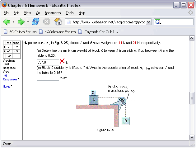

Basically, so far we've done kinematic equations, forces, vectors, and now we're doing things like blocks moving down planes with tension and stuff, and the latest part is what is killing me...I just can't understand what's going on.
For example, here's one example problem:
It's just so incredibly confusing to me, no matter what I do to try to learn. frown.gif
And the hard part for me is always setting up the equations...the calculus and algebra and trig. are fine.

B Block:
T - mg = ma
A Block:
T - F(f) = ma

try drawing free body diagrams, they help!! describe all forces on al the blocks, it will help you visualize what forces are in the y or x direction.
well, in this example problem follow the strings... block B is pulling down on the string with a force of 21 N. So you need a minimum of 21N pulling on the other string to keep it from falling. The force that is pulling back in the direction of the string is friction. The force of friction in the string direction is F= (mu)Fn. So the force of friction needs to be 21N, and that must equal the normal force of block A and C times the coeff of friction given. So you have:
21N=(0.2)(44N+c)
comes out to c=61N
for part b, lets assume that there was no friction, then block b would fall at 9.81 m/s^2 because there is nothing opposing its fall. Thus it would drag block A with it at the same acceleration. But with friction this isnt the case.
So using F=ma, find the mass of block B assuming no friction. Thats just 21N=(m)(9.81)
now add friciton, (Force of B)-(Force normal of A)(coeff of friction)=(mass of B)(a)
solve for a
**edit** if this is wrong, someone please correct me. I havent done this is a while

I managed to get the first part right, but I couldn't get the right answer for the second part. I got 6.14, 3.2, and 6.72, but none of those were right, and I still don't understand what's going on.

i use to have physics HW online as well.... make sure you have the correct significant digits. Its stupid, but a lot of times the computer will accept the answer 6.198 and not 6.2

coomer are you using the static friction formula in part b?
post a picture of the work you did, so we can see what you did wrong..
