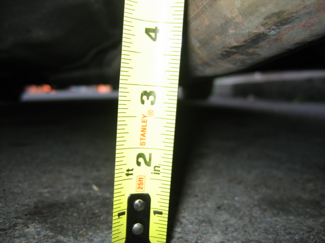

post Sep 7, 2005 - 3:15 PM
nik
Joined Sep 30, '02
hey can you measure on flat level ground from the bottom of your 3" exhaust to the ground at the point where you rerouted it.
post Sep 7, 2005 - 5:48 PM
QUOTE(nik @ Sep 7, 2005 - 4:15 PM)
[right][snapback]331767[/snapback][/right]
yea, i can prolly try to squeeze under there and take a pic actually, with a tape measure in there. wink.gif
:edit:
heres the pic nik:
post Sep 7, 2005 - 6:04 PM
nik
Joined Sep 30, '02
thanks my 3" is routed around it I might cut to do like you did but i'm still thinking about it alot of speed bumps are crazy big over here for some reason thanks again your the man

post Feb 8, 2006 - 9:08 PM
Celiracer18

post Feb 8, 2006 - 9:11 PM
QUOTE(presure2 @ Sep 7, 2005 - 5:48 PM) [snapback]331842[/snapback]
:edit:
heres the pic nik:
damn manny, your car is LOW
post Feb 8, 2006 - 10:05 PM
DG_Performance
Joined Jun 21, '03
From Pennsylvania
wow.... only 3" to the pipe is low! but if you guys are worried about speed bumps think of it this way. The low part of his exhaust is directly between the rear wheels and will lift up as you drive slowly over the bump, so it should still have a 3" clearance going over the speed bump. The only real problem is road kill or objects sticking up in the road or big ass holes like i got here in PA .....things that both rear tires do not drive over at the same exact time!

post Feb 9, 2006 - 11:33 AM
yup straight pipe turbo back.
its low, but where the exhaust travels with the chassis, so i just about never scrape. like DG said, if i hit a tire popper, (HUGE pothole ) it gets close..and even then, ive only hit once or twice since ive had it, and thats mostly on dirt roads, not the street.
its really not that loud, except @ WOT.
