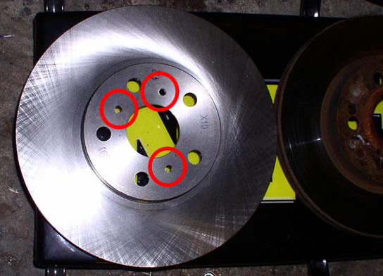

On my ST185 front rotors and on my factory ST rotors, I have small holes near the holes for the lugs. They're circled in the picture below, which is one of my ST185 rotors. I would think that ST204 rotors would have these holes.
It didn't look like the 12mm bolts would fit into there, but they did and they go in smooth once they're started. I used one of the two holes that are close together and the other hole on the other side of the rotor. If the ST204 does have these holes, I'm not sure if they'd be the same size. I'd think so, but you never know, so just try a few bolts and see if you can find something that works.

Thanks guys. SCM, I figured out what you posted just a few hours ago and knocked the lugs out with the rotors attached. Longer lugs go in fine. Seating the new lugs is not a fun exercise though. I have one spacer and wheel on and it looks VERY good.
