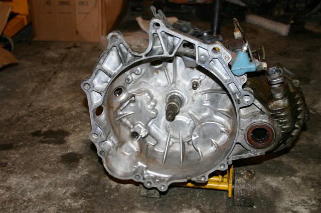

Tranny all cleaned up:

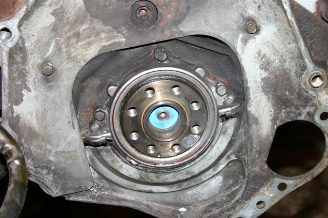

Pin on crankshaft ground off:
Stage 3 clutch installed, and getting ready for tranny attachment:
Bolting up the tranny:
Engine dropped in:

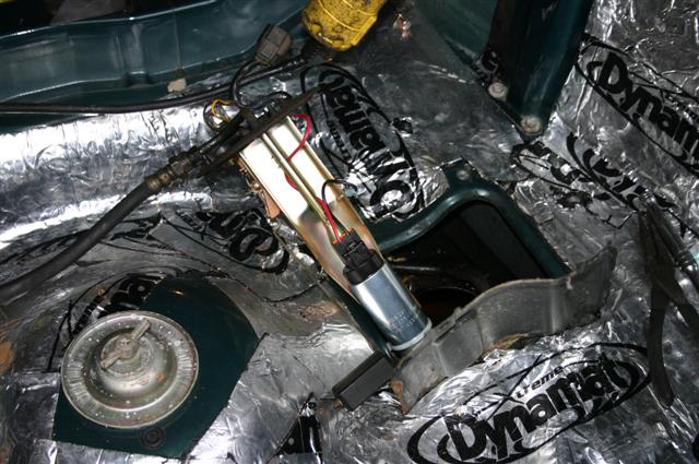

Walbro pump installed:
I've got the engine started but I'm dealing with a problem with it revving up by itself. More updates to follow.

Got the engine going yesterday after fixing a fuel pump short and a leaking intake manifold gasket, runs great smile.gif Going to the exhaust shop today and getting some gauges, and a few other things finished up.
