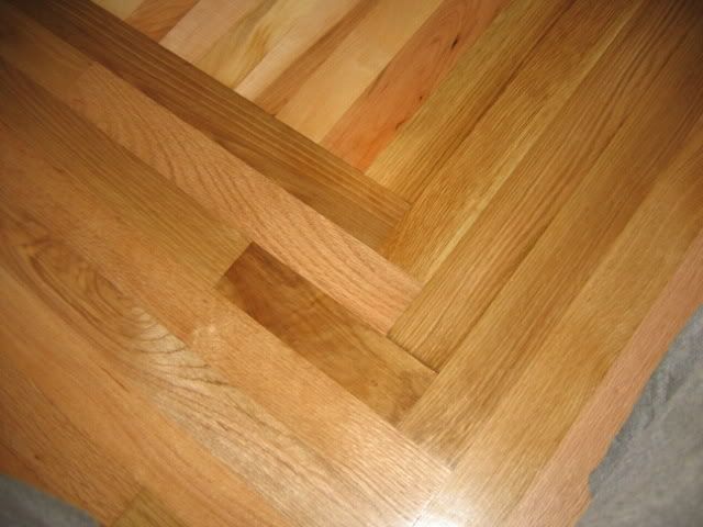

then continued on with the border from there:
a close up of the border:

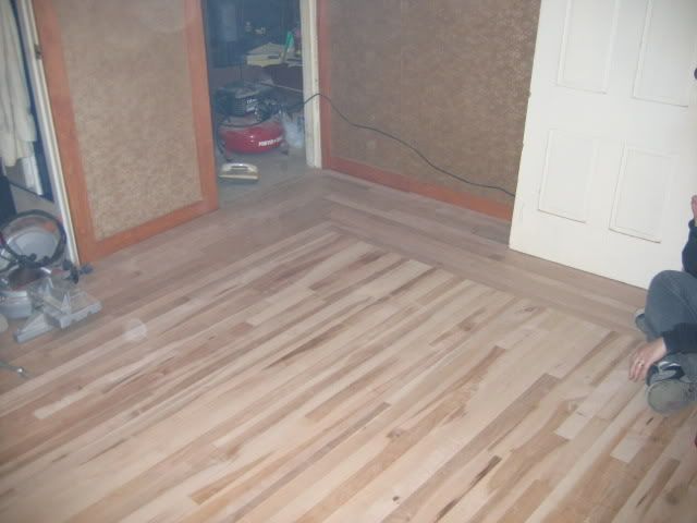

once the border was laid, i started filling the center with the maple:

then just continued on till it was finished:

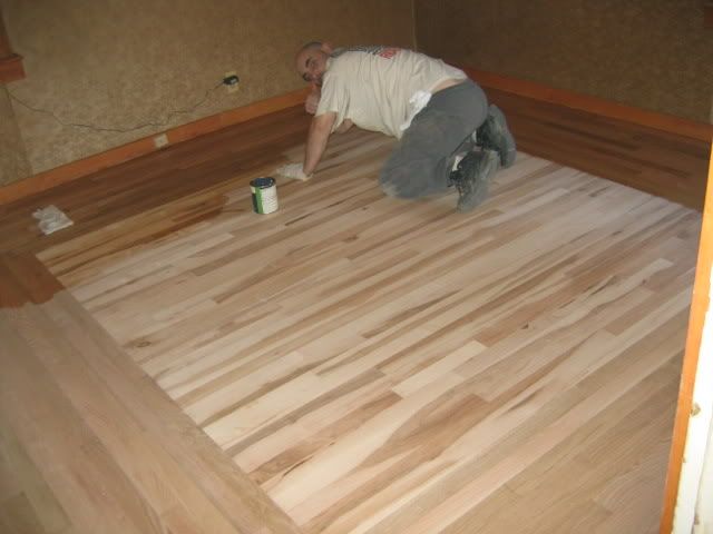

once it was all sanded smooth, i started staining it with a natural stain to bring out the highlights of the grain in the wood:

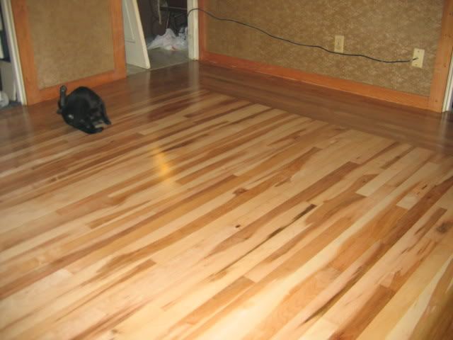

once that was dry, a couple coats of water based finish, and call it done!
not too shabby if i do say so myself for a first attempt at boarder-laid!

why a staggered joint in the corners and not a loose tunged mitered joint ?? plus what finish did you use on it, you got a great finish smile.gif

thanks everyone,
pop, i had never tried the staggered look like that before, something new.
