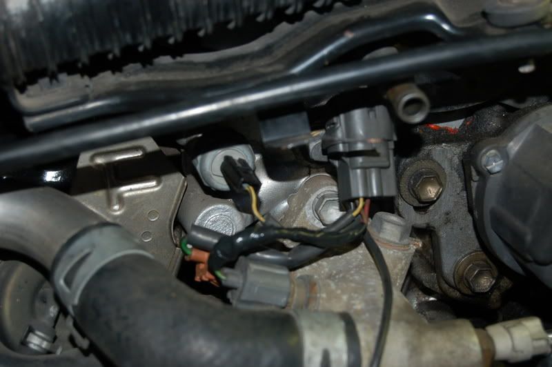

Edit:
Ok so here is a pic, its the one with the yellow wire correct??
So while this is all apart where should i tap to put in the water temp sensor??

post Dec 24, 2006 - 10:07 PM
jcbass7
Joined Apr 20, '06
From Florida
Reputation: 44 (100%)
i found this thread on MR2OC, but i don't want to replace the stock sensor, because then i will loose that gauge in my cluster... and it will look stupid on the C all day.. lol
http://www.mr2oc.com/showthread.php?t=1718...ater+temp+gauge
I'm guessing i can just tap the neck somewhere, but im still searching so i tap it in the right spot and don't F anything up.
