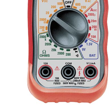

Let me know exactly which settings and and how I connect leads to this meter. I see 3 different inputs on this meter (10A/COM/V)
Im guessing I need to connect leads to 2 of those ports- Would it be 10A and COM or the COM and V port?
Set Dial to Adc, 10A?

The multimeter is fused, so the 10A means that it has a 10A fuse. I guess you have a 200 mA fuse where you have the VΩmA port. So, connect the red lead to the 10A port first to check if the draw is higher than 200mA, if not, you can connect the red lead to the 200 mA port. The black lead goes to port COM. Set the dial on the multimeter to ADC 10A first. You can clamp the black lead to the battery negative post, and the red one to the negative lead cable. Then start pulling fuses and you can see wich circuit that has the draw. Hope this helps smile.gif

When Im on the 10A scale - should the readings be displaying decimals or would it likely be just a whole number like 25
http://s7.sears.com/is/image/Sears/0348214...=1&fmt=jpeg

You want the red lead on your multimeter at 10A.
There should be a common ground for the black lead.
It should be black.
Put one lead on the battery post and the other on the battery cable.
If you're good, you can touch each first, then slide the terminal off the post. This will keep your memory intact.
It should be less than .050A.
