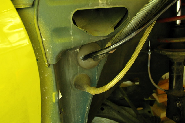

I ran mine through the rubber piece on the passenger side where the harness goes through. Easy if you already have the fender off. Otherwise, there are easier places to run it. wink.gif
It's the black wire without loom in that picture.

My installation was almost the same as yours Coomer, except I did it on the driver side, used the lower of the two grommets and didn't remove my fender, just the tire well plastic.
Just a picture showing where it runs from through the fender. I used Zap Straps to tie the 4ga. wire along the black sheathed wires at the top on the inside of the fender.
Here I had the grommet popped out to see if the wire would feed through, and it did. The red dot just shows where I cut a hole in the grommet to feed the wire through.
And after the rewiring was complete. I added gold battery terminals, a 4ga. ground wire off the battery and I have the fuse block ready for the 150A fuse (Once I find it... tongue.gif )
