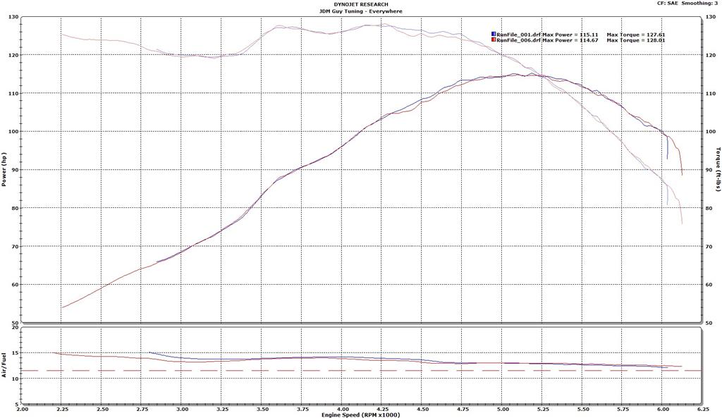

post Feb 4, 2008 - 5:10 PM
heres what a good condition, lower mile 5s will look like on the dyno.
this is with a injen short ram intake only.
this is from my car, pre turbo.
the engine had under 55K on it.
post Feb 4, 2008 - 8:58 PM

on this dyno what's the line that initially starts low, and what's the higher one?

Rusty
Joined Nov 5, '07
From New Zealand
the top one is for torque(unless we all have 125HP at idle)[use the right axis to find the reading]
the lower one that starts off is the power (HP)[use the left axis to find a reading]
so looking at rpm (right down the bottom) 90HP @ 3750rpm
(hope I dont sound like a school teacher)

Kwanza26
Joined Dec 27, '03
From Nor Cal
QUOTE(JasonX @ Feb 5, 2008 - 1:58 AM) [snapback]638065[/snapback]
The first dyno is not what a stock 5SFE dyno looks like. That's vastly improved over stock by about 10-20whp depending on the motor's condition, and the torque curve is significantly better. Typical 5SFE's will run out of breath around 4500 rpms and the torque dips significantly. The top dyno doesn't lose much torque until around 5300-5400 rpms. That is a significant difference in terms of accelerating the car. IMO, whoever that dyno belongs to, can still squeeze extra power with some good cam tuning.
As far as which is which, the flatter line that starts flat is usually the torque (applies to most engines) and the line that climbs as the rpms increase is horsepower.
