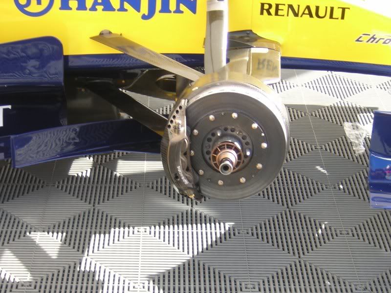

The reason for the creation of cross drilled rotors initially was to remove the "gasses" from the brake pads. HOWEVER, most of your modern brake pads (Axxis metal, AEM semi-ceramic) do NOT produce gasses when heating. This was on bad brake pads used in the 1950s and 1960s. Back then, asbestos was also used, and we dont use that either.
also physics 101....braking power comes from friction of pad to rotor....take away surface area what happens?! LESS braking power
Cross drilled rotors have LESS contact area because of the holes.
But if the rotor is cooler, its better, right? Well no, because these rotors are not cooler. THe heat is generated from the pad/rotor contact. What removes heat the most effectively? When stopped or moving, the pad transfers heat into the rotor because its made of cast iron. the rotor has a lot of surface area and even vanes in it. But the little holes allow air in this surface contact, and you can transfer more heat into a solid big ass chunk of cast iron more than you can into the air. Don't believe me? Touch some steam at 150 degrees, then touch a piece of hot metal which is at 150 degrees. Which burns your hand? the metal. So let the heat transfer into the metal, because since it has so much more surface area, dissapates better.
Find me an F1 car as of now that uses cross drilled or slotted rotors.
They all use full ceramic rotors and ceramic pads. Are they drilled or slotted? No.
If they helped the fastest cars in the world, wouldn't they use them? Its basic calculations that show the lack in surface area does not make up for the possible loss in temperarure. They use brake cooling air ducts insted.
This post has been edited by playr158: Apr 1, 2008 - 10:59 AM

you need some heat to get them to optimal performance, brake fade is usually cause by brake fluid getting hot and losing its properties
blanks ok, slotted & vented are the best performance, as long as you upgrade the size.
same everything except rotors
12" vs 12" rotors one being solid, the other slotted, the solid is going to perform better.
12" blank vs 12.5" slotted, the slotted should be equal if not better PLUS much more pleasing to look at.
before anyone posts anything to shot this, or plyr's posts down, get some technical data to support it. not this car with slotted and drilled performs better than another car without.
here's an f1 car's brakes, notice, blank vented, these glow red hot turn after turn after turn and still provide best stopping without warping as easy ( i presume they are also some crazy material, but the engineering is the same )

The brake's only purpose is to convert kinetic energy into thermal energy and dissipating it. When your brakes are warm before stopping, its just that much less energy they're capable of removing. The disk can only handle so much heat at a time, and then you feel brake fade.
Back in the day, bake pads had resin in them that would vaporize when they were extremely hot, it could be trapped between the pad and the disk and limit friction. Cross drilling gave the gas a place to go, also lightened and weakened the disk
Now days, pads aren't made like that, no gases, but they do transfer heat to the caliper now, and like Jason said, this causes boiling brake fluid, which decreases hydraulic pressure. brake fade.
Either way, heat is the enemy
And your right jason, F1 brake disks and pads are made of carbon, which... ironically.. grips harder the hotter it gets thumbsup.gif

1) cross drill and slotted cool faster, great for racing (porsche and benz do it for style cause you dont race them but they are SPORTS CARS)
2) grip is dependent almost entirly on pads and rotor diameter
3) rotors crack because of ****ty metallurgy (bad casting), so buy expensive ones
a) glad you did some research, keep researching and learning
b)
"braking power works off heat"????
Im going to save you some face and let you google the word "brake fade" before posting again
I'm going to save you some face and let you use a dictionary or something and learn "operating temperature". Yes brake fade comes from TOO much heat and an incorrect/not up the the task brake system setup. But there are various points to a pad's functionality. When you are looking at pad compounds there is a factor of "cold bite" this means a cold brake pad. Brake pads just like your motor need to warm up in order to give full functioning and achieve their maximum potential. This is why you don't use track pads on the street. They need HEAT to get to their operating temperatures. So thank you yes braking power works off heat. Think of braking power as a function of a parabola. Initially braking not so good, temp comes up braking power is getting better, but too much heat and you get diminishing returns (brake fade)
c) on "#1" you failed again. Race cars DO NOT USE D/S rotors. Mercedes Benz is not a sports car either laugh.gif
