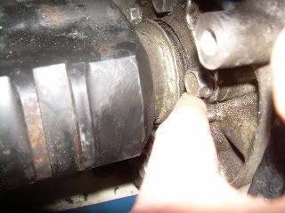

Do i want to pry underneath that metal ring? It looks important, its a soft metal and you can see i already bent it up a bit already.

No, that's the dust shield, it protects the trans seal from dirt/debris.
Put a prybar against the inner joint where it meets the shaft and whale the crap out of it with a hammer.
To install make sure that clip has the opening facing DOWN.
well, thats where i hit mine, altough ^^^ has another way, make sure you dont mess up your axle, as you dont want to buy new one. meaning dont pull from the axle tip!!!
I ended up just bending the dust shield to shape.

sure enough! A couple hard jerks with a pry bar between that first knuckle and the differential casing and it finally popped out
