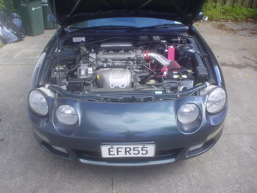

I'm really keen to get my pod filter on but unfortunately my SRI pipe doesn't have the correct nipples on it so in the mean time I got this idea from staring at Rusty's engine for a while that I'll use a 3" plastic joiner to connect the pod filter onto the stock rubber pipe and I've pulled out the resonator box and measured the connector diameter at 52mm so I went to a home building supplies warehouse and purchased a piece of PVC plumbing pipe to fit the hole with a cap on the end. I drilled a 20mm hole in the cap to place the rubber grommet and temperature sensor from the air box.
SRI, needs different nipples to be used with 3S-GE
cheap wildcat filter, does the trick
3" joiner plastic already connected to pod filter
This post has been edited by delusionz: Jun 13, 2008 - 11:57 PM

QUOTE (delusionz @ Jun 13, 2008 - 4:58 PM) *
I think I did something similar today, heh. Is this what you were meaning?
Now to go for a drive and see if it falls off. *cough*

Hehe It looks exactly the same, I haven't taken a photo yet because its cloudy and crap outside. I'm on the hunt for a 77mm PVC pipe which i can drill holes in for the vacuum lines and connect that up with my aluminum short ram pipe but all i can find is 10 metres of 80mm lol.
Man does this engine ROAR with a pod filter. I'm keen to get rid of the stock rubber pipe though, I think it gets constricted under high vacuum.
