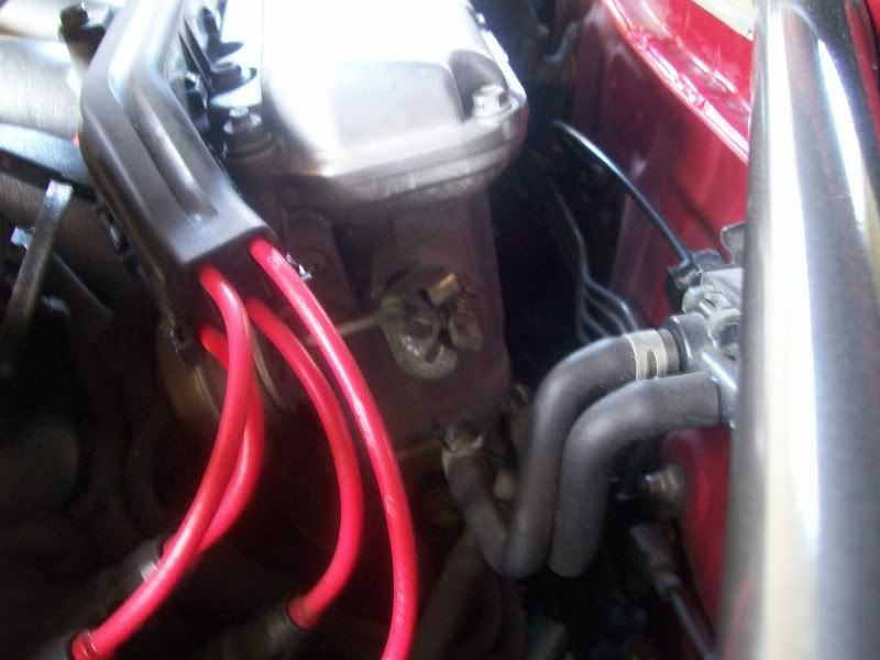

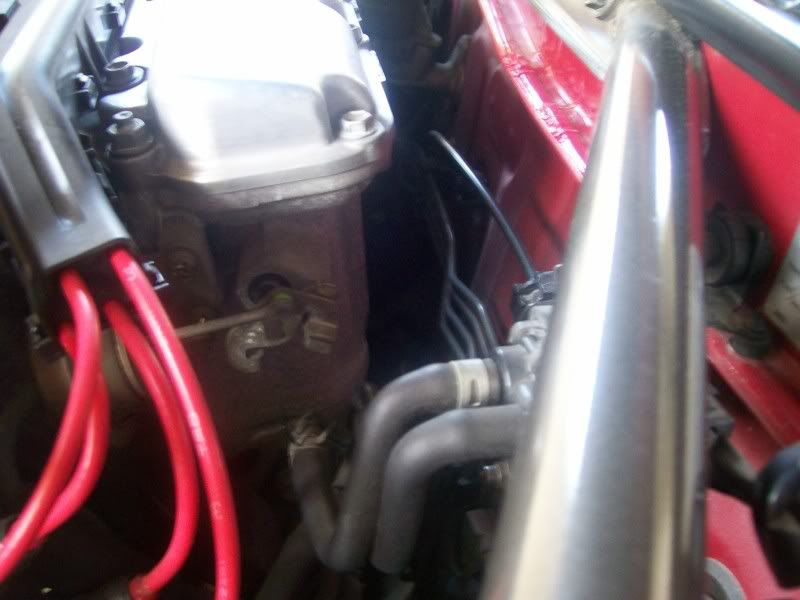

anyway here are some pics of my motor to help I guess?
CAR OFF
Idle
High Revs/Change over
^ ACIS just kicked in Yo (sorry couldn't resist)

Dude,
You've been the most helpful to date, judging by the position, this is where I readjusted it based on feel and drive.
I will get my other half to rev the engine to see where the acis kicks in biggrin.gif
