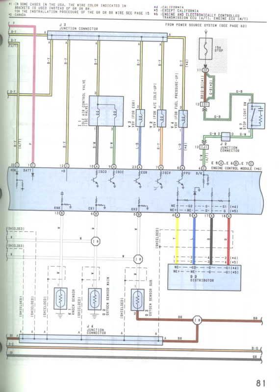

went to swap out throttle bodies and the plug from the harness to the Idle control valve had been tampered with by the previous owner and the wires pulled out of the clip.
So my issue lies in the fact that now I do not know which wire goes into which port on the plug. I need to know so I can re-wire it.
My question, and the favor I need doing is just for someone to take a peak and let me know which colors to to what port. The ports are numbered and the wires are colored (i mean multicolored...im not a racist) so it shouldn't be too difficult.
