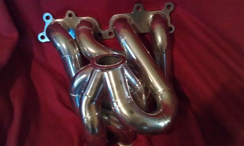

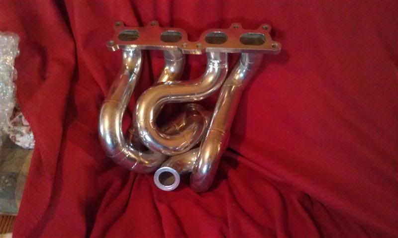

post Oct 21, 2011 - 4:11 PM
email jeff from racerxfabrication.com
he does great work, can custom make it to your specifications.
a couple pics of the manifold he made for _jim_s 3rd gen stroker i am building for him:

post Oct 22, 2011 - 9:40 AM
we havent run this one yet, but there are several guys on mr2oc using them with great results.
he builds each one to custom suit that customers needs.
runner length and size is determined by desired powerband, ect. really good stuff.
