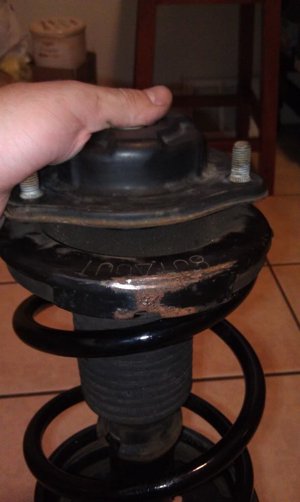

So I took the strut out, and here is what I found.
So thats obviously the issue. Now the odd thing was that the metal mount was pointing in the correct direction.
After thinking about it and further inspection I noticed that the very top portion of the mount (with the studs) was kind of on there crooked due to it not being lined up with the two notches that hold the upper mount inline with the strut rod. So I took everything apart and lined it up again and zipped it down really well with an impact gun.
So far the problem appears to be gone, but I have yet to take the car out for a full test drive.
And yeah, there was no need for a spring compressor. At least not for the fronts as they were easy enough to push down by hand.

post Jun 7, 2012 - 9:56 PM
Oh! I actually noticed that on mine as well but didn't take a picture of it.
I guess the top part gets stuck from not having enough space in the strut tower to move freely (hence why mine looks damaged) and then doesn't let the strut turn freely so the bottom part of the springs start to rub.

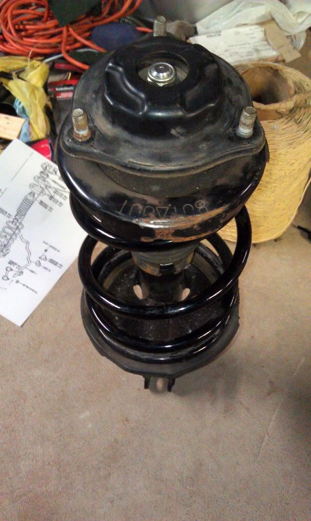

post Jun 7, 2012 - 10:02 PM
Actually here is another pic. You can see everything was lined up but there was still rubbing at the bottom of the springs.

I replaced the bearing and the mount and all seems to be well again.

its either the top mount or bearing of it or the shock bump stops are gone.

post Jun 28, 2012 - 8:15 PM
QUOTE (trdproven @ Jun 28, 2012 - 9:05 PM) *
Did you see the pic I posted ?
The bearing was bad and fell apart into pieces.
I replaced it with an oem bearing and a new kyb strut mount.

yea i saw it, i was mentioning what could have been wrong, those balls come out into pieces especially when you remove the mount. its good to always buy new ones.

Damn so problem solved?
Howcome it only fell apart this time and not when you lowered it?

maybe he reused the old bearing. IDK, old bearings get busted, then the balls fall out.

post Jun 29, 2012 - 8:18 AM
QUOTE (jordisonjr @ Jun 29, 2012 - 12:09 AM) *
Yeah, the problem is solved. Seems the bearing was damaged inside and eventually busted open.
