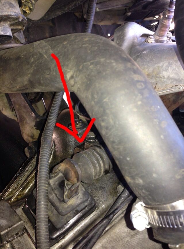

Cables are fine, they're moving and in good condition (I dot see any cable move when clutch pedal is depressed. They move only when the gear lever is moved. That's normal rite?

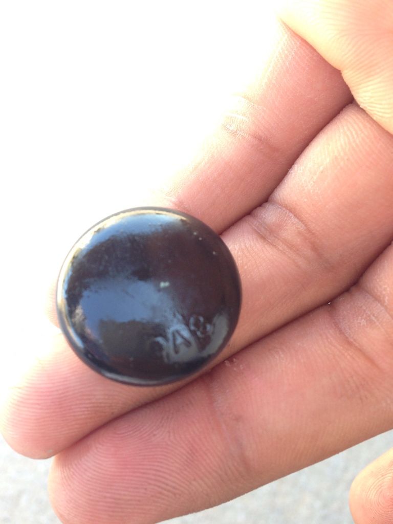

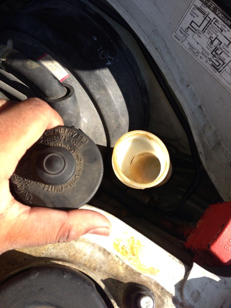

I put some brake fluid dot 3 in the master cylinder thing and found this in there floating. What's this? Is it suppose to be there?

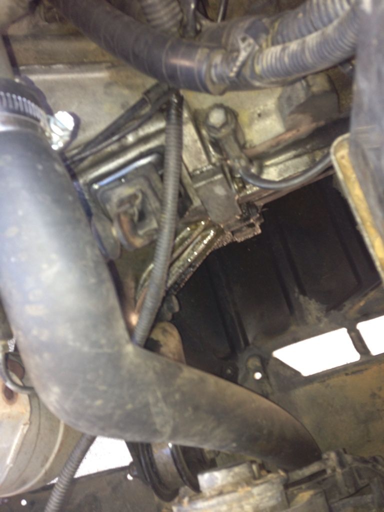

Found some fluid around here looked like new engine oil but not sure the car shouldn't have clean oil it has about 1900 miles from the last oil change
Also this slave cylinder doesn't move at all when clutch pedal is depressed.

Yeah, that float is suppose to be in there

Your hydralic system is leaking somewhere, by the pictures it looks like your slave is blown. There should not be any fluid types around that area. If there are, it is going to be the clutch system fluid. If your trannie was leaking, it would be on the underside where the axles, or fill, drain plugs are.
That item floating in the master res doesn't look familiar to me..kind of odd.
You need to find that leak, and replace it.
The system itself isn't that intricate.
There is the master, 4 hard lines, 1 soft line, and slave cylinder. I would start with the slave, and work my way up to the master repairing any leaks. Try to avoid tinkering with the hard lines unless you know it is leaking from there. Them being old, often are a pain to work on, and prone to break.
