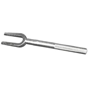

check out this how-to on replacing the CV axle assembly, it's basically what all will have to happen to get the steering knuckle off and remove the ball-joint.
http://www.6gc.net/forums/index.php?showto...2;cv+axle\
the steering knuckle is held in place by the strut bolts on the top, and the ball-joint on the bottom. the ball-joint has one nut with a cotter-pin through the top.
all you have to do is take that off but once the nut is off you use a big "pickle-fork" and smack the crap out of it till it comes apart from the knuckle.(not the most fun you've ever had)
then the bottom of the ball joint fastens to the control arm with three more nuts on the bottom. Still you have to take the CV axle out so look at that 'cause you'll need a new transmission seal to put it back in, or you may want
to get a new axle while you've got it apart.
If you need a new "boot" for the ball-joint you really want to go ahead and replace the whole thing, generally if they see a worn boot, they assume the joint must be worn out.
in fact, even if you just need to take it apart to change the CV axle, you will ruin the boot on the ball-joint when you smack it with the pickle-fork so you have to replace it anyway.

if you know your axles are good then yes, you can probably remove the ball-joint without taking the whole axle out.
maybe just turn the wheel to the side so you can get to it, remove the top nut and pin, then stick that fork where the boot is and smack it apart.
then take the bottom bolts loose.

I've always had to take the axle out, tried the fork and just popping it. Gave up, spent the money for the correct tool, and popped right out easy peasy.
