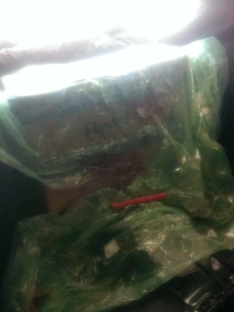

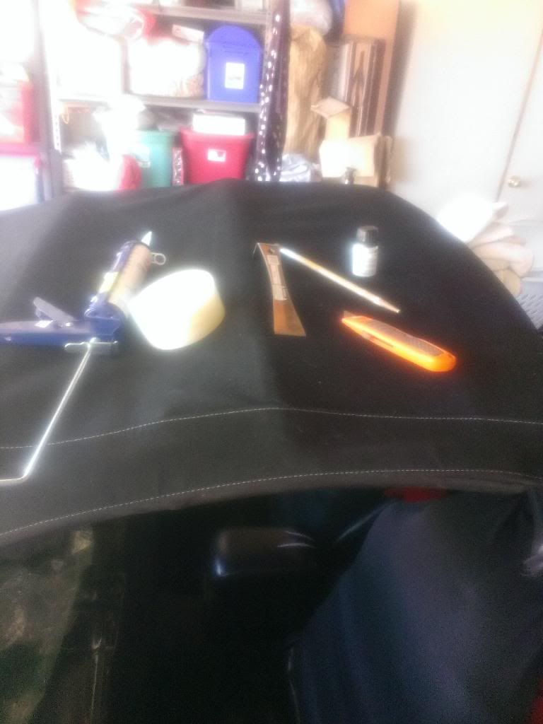

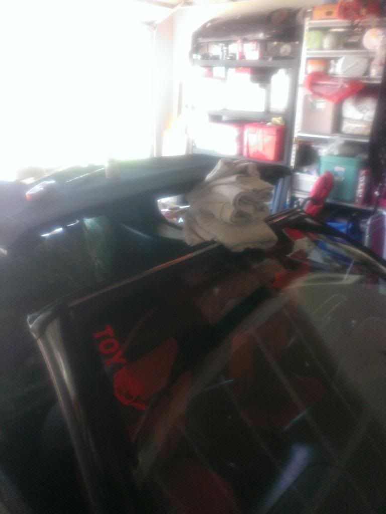

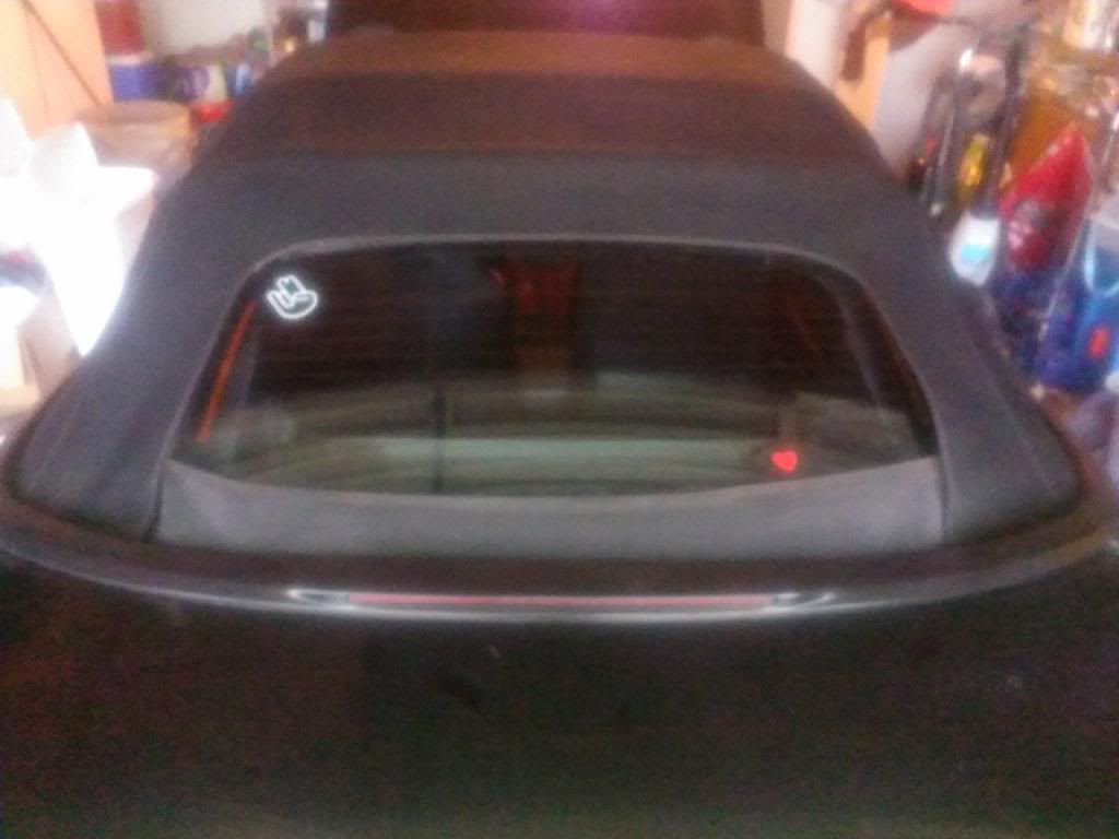

Well First and foremost i would like to thank MaskedMan for the suggestion of reattaching my rear window you literally saved me a lot of money
got all the supplies to begin
prepped my car to avoid getting dirty because ive read it can be quite messy
and after all the time and effort it took me about 2 days
but i must say it almost looks new and even though i got frustrated a bit i was able to get it done
here it is now and i must say it was quite messy job i got windoweld all on my skin an it was a pain to get off but it wass worth it i got the window reattached and the glue actully looks like its very strong in holding the windshield and well yea screw paying 800-1500 bucks just for the part and the labor from those shops so again thank you so much MaskedMan

post Mar 12, 2014 - 4:22 AM
MaskedMan
Joined Jun 29, '03
From 캘리포니아
Good job! Looks great! Some parts can be a bit challenging, but I think it's well worth it to save yourself a good chunk of money. Glad I was able to help biggrin.gif
