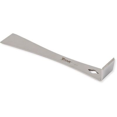

Welcome to the club. I'm about to get a new oil pan. I've taken mine off and put it back on twice already. The first time I did the "4mm" bead recommended amount by the books. It leaked in that same spot.
I then did a bead that was like 3 times as thick. It's leaking again. I'm about to just grab some grey permatex stuff and smear it across the surface, or get a new oil pan.
P.S. I used this type of pry tool
http://contentinfo.autozone.com/znetcs/pro.../11513/image/4/
The flat side is thinner, and you can make it fit between the mating surfaces, and then just slide it across to break up the silicone a bit.
