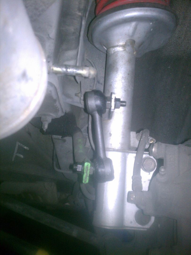

To get started...Here are pics of the front stock endlinks still installed. Needs no explanation, looks weak, thin, and breaks fast.
Here are pics of the comparison side by side for the front. As you can see the MEVOTECH front links are much beefier. As Spider once mentioned they
are 13mm compared to the stock 8mm on the rod size. Comes with a nice blue boot cover but thats just for show. I read that the black boot covers are
the newer designed ones (supposed to be better) which i've seen as well but dunno the difference of how some say its better. FYI, MEVOTECH for some reason offers their beefier models for both front and rear for our model. For other cars, MEVOTECH sometimes provide the stock skinny ones for example for the 7gc. I guess we are lucky. The reason why i decided on getting MEVOTECH for the fronts and not MOOG all around is because MOOG front links seem to be like stockish looking and its size - I did not know for sure but i've seen the fronts for other cars and they size up the same as stocks.
Here are pics of the MEVOTECH Front endlinks installed. Nice!

MEVOTECH
now as you can see people masked man was right. its the placement of the rod. as you can see by the angle isn't that harsh at all. I will be bending the tab a bit more outward to get it to fit nicely like an oem size/style end link. so each joint is at 90 degree. I just have to return these ($112 from orielly) and buy a set online (once i get a job)

- - Spider77   This is what I got back from MevoTech "Please...   Jan 25, 2013 - 5:40 PM
- - BonzaiCelica   yes dude that is the problem. masked man let me kn...   Jan 25, 2013 - 6:44 PM
- - azian_advanced   Spider77, do you have pics of the endlinks while t...   Jan 25, 2013 - 10:30 PM
