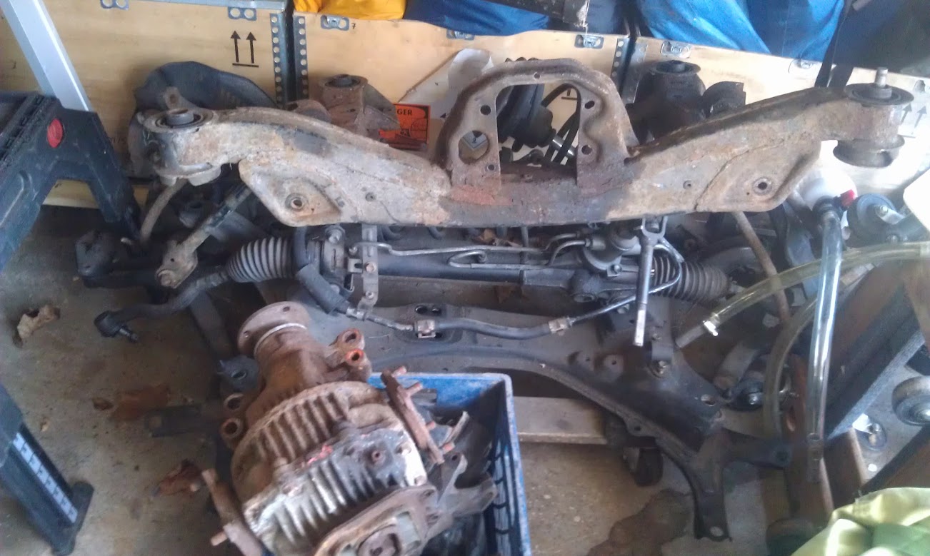

I bought a new rear end setup. The stuff I bought from the UK was completely rusted and f'nasty:
You can seen some of the new gear here:
In other news... got the fuel tank and the rear end out:
I created camera rig to help visualize where the new suspension lands with respect to the original suspension... it will be interesting to see if it worked... won't be able to try this for a few days though.
