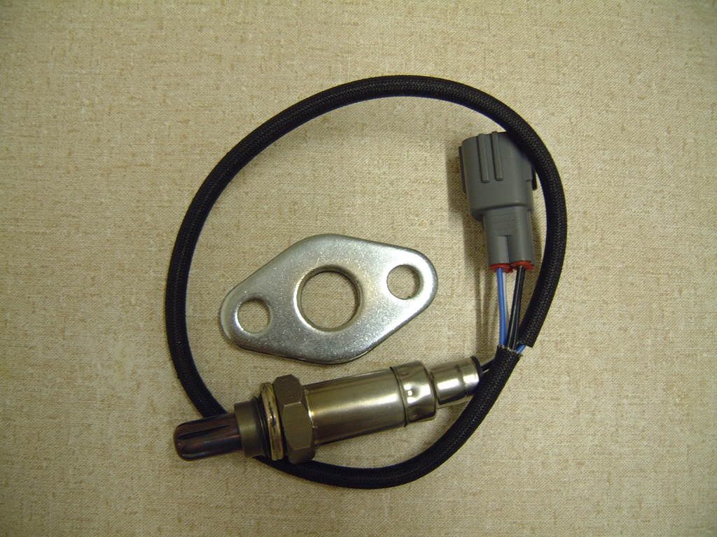

got my exhaust installed today. I have a check engine light on. My 2nd 02 sensor is not installed yet. The one on the car has a bracket with two holes and the cat I have has a threaded hole for the sensor. Do they make one for the car that has threads? I found one at the parts store but it only has one wire. 95 st. 7afe

- - Box   Being you have a 1995, try shoving a paper clip in...   May 28, 2013 - 6:30 PM
- - Bitter   They make adapters. http://www.ebay.com/itm/O2-SE...   May 28, 2013 - 8:25 PM
|- - Box   QUOTE (Bitter @ May 28, 2013 - 8:25 ...   May 28, 2013 - 8:54 PM
- - timdog1720   The braket comes off ... If im understanding you r...   May 28, 2013 - 8:33 PM
- - fatherof4   I did not know it would unscrew. I have to extend ...   May 28, 2013 - 8:48 PM
- - Bitter   OH, I got it backwards. I don't think they mak...   May 28, 2013 - 9:24 PM
- - timdog1720   okay question ???? does the O2 sensor you have , d...   May 28, 2013 - 10:38 PM
- - timdog1720   but you know what lets see what other guys say cau...   May 28, 2013 - 11:09 PM
- - Bitter   I'm still backwards. I think he's saying ...   May 28, 2013 - 11:22 PM
|- - timdog1720   QUOTE (Bitter @ May 29, 2013 - 12:22...   May 29, 2013 - 1:11 AM
- - Box   On the OBDI 7A-FE you have an one wire O2 sensor t...   May 29, 2013 - 1:12 AM
- - Bitter   I don't think the flange comes off, I'm pr...   May 29, 2013 - 7:12 AM
|- - Box   QUOTE (Bitter @ May 29, 2013 - 7:12 ...   May 29, 2013 - 11:37 AM
- - Bitter   Odd, I swore I've seen 7A's with and witho...   May 29, 2013 - 7:28 PM
- - Box   The Corolla I believe didn't have the pre-cat ...   May 29, 2013 - 8:13 PM
- - fatherof4   I checked today and I could not get it to unscrew ...   May 29, 2013 - 8:46 PM
- - timdog1720   if i had to assume I would say yea if its for a to...   May 29, 2013 - 9:49 PM
- - Bitter   I think you can just splice in a universal thread ...   May 29, 2013 - 10:25 PM
- - fatherof4   I'll pick up a universal this weekend and give...   May 29, 2013 - 11:00 PM
