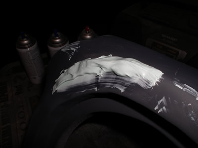

post Mar 5, 2004 - 8:37 AM
As Doggy pointed out, there's quite the flat spot at the top of the enclosure on the outside ring. So I just applied a bit of Bondo to the area where the flat spot is, and I'll sand down that area once it dries so that it's rounded like the rest of the enclosure. smile.gif
I'll leave you guys with a photo of me getting liberal with the Bondo on this area. wink.gif
