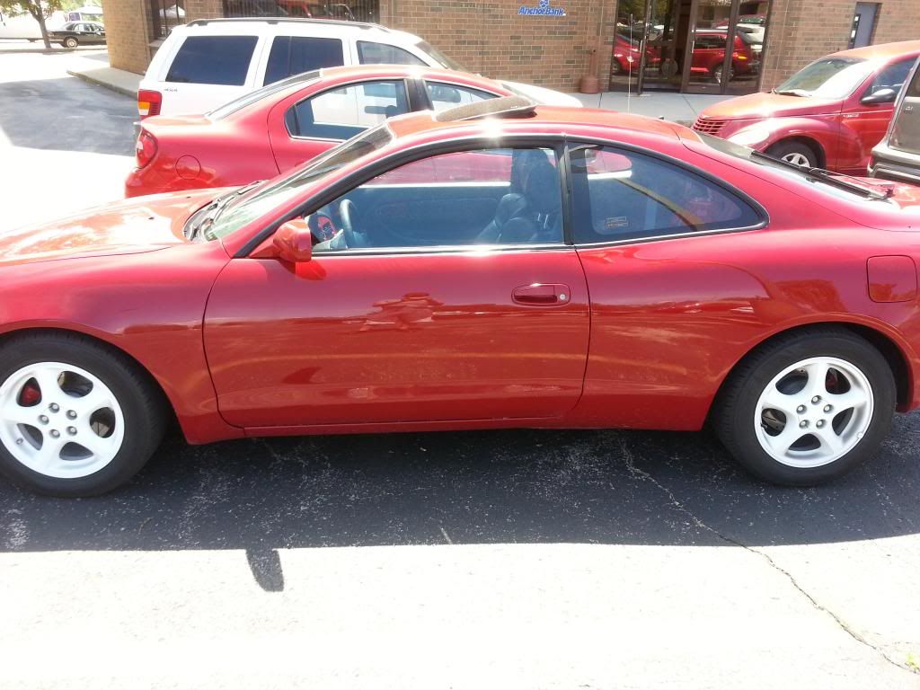

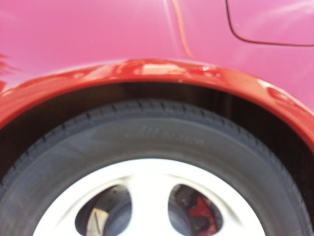

Just for a reference, this is my stance and close ups of me on KYB GR2 Mounts and Struts, and Tein S-Tech springs. Also on OEM alloy wheels.
Front
Rear
Full Stance

- - cyberblader1130   Just for a reference, this is my stance and close ...   Aug 8, 2013 - 8:44 PM
